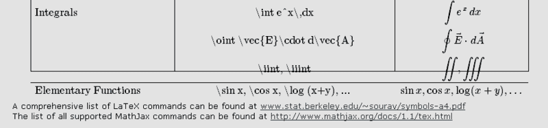

Frequently used symbols A nice list of frequently used symbols can be found at http://www.artofproblemsolving.com/Wiki/index.php/LaTeX:Symbols
Here we give a small sample of symbols you might want to use:
[tex]\begin{array}{|c|c|}<br /> \hline<br /> \text{\frac{1}{2}} & \frac{1}{2}\\<br /> \hline<br /> \text{\sqrt{16}} & \sqrt{16}\\<br /> \hline<br /> \text{\sqrt[4]{16}} & \sqrt[4]{16}\\<br /> \hline<br /> \text{\infty} & \infty\\<br /> \hline<br /> \text{\hbar} & \hbar\\<br /> \hline<br /> \text{z^*, \bar{z}, z^\dagger} & z^*, \bar{z}, z^\dagger\\<br /> \hline<br /> \text{\hat{z}, \vec{z}, \tilde{z}} & \hat{z}, \vec{z}, \tilde{z}\\<br /> \hline<br /> \text{\frac{ \partial f }{ \partial x }} & \frac{ \partial f }{ \partial x }\\<br /> \hline<br /> \text{\forall, \exists, \cup, \cap, \bigcup, \bigcap, \setminus, \in, \subseteq} & \forall, \exists, \cup, \cap, \bigcup, \bigcap, \setminus, \in, \subseteq\\<br /> \hline<br /> \text{\langle \phi | \psi \rangle} & \langle \phi | \psi \rangle\\<br /> \hline<br /> \text{\rightarrow, \leftarrow, \Rightarrow, \Leftrightarrow} & \rightarrow, \leftarrow, \Rightarrow, \Leftrightarrow\\<br /> \hline<br /> \text{\geq, \leq, \approx, \cong, \sim} & \geq, \leq, \approx, \cong, \sim\\<br /> \hline<br /> \text{ \binom{n}{k},{_nC_r}} & \binom{n}{k},{_nC_r}\\<br /> \hline<br /> \text{\sin(x), \cos(x), \log(x)} & \sin(x), \cos(x), \log(x)\\<br /> \hline<br /> \end{array}[/tex]
A comprehensive list of LaTeX commands can be found at www.stat.berkeley.edu/~sourav/symbols-a4.pdf[/URL]
The list of all supported MathJax commands can be found at [PLAIN]http://www.mathjax.org/docs/1.1/tex.html
[tex]\begin{array}{|c|c|}<br /> \hline<br /> \text{\frac{1}{2}} & \frac{1}{2}\\<br /> \hline<br /> \text{\sqrt{16}} & \sqrt{16}\\<br /> \hline<br /> \text{\sqrt[4]{16}} & \sqrt[4]{16}\\<br /> \hline<br /> \text{\infty} & \infty\\<br /> \hline<br /> \text{\hbar} & \hbar\\<br /> \hline<br /> \text{z^*, \bar{z}, z^\dagger} & z^*, \bar{z}, z^\dagger\\<br /> \hline<br /> \text{\hat{z}, \vec{z}, \tilde{z}, \dot{z}, \ddot{z}} & \hat{z}, \vec{z}, \tilde{z}, \dot{z}, \ddot{z}\\<br /> \hline<br /> \text{\frac{ \partial f }{ \partial x }} & \frac{ \partial f }{ \partial x }\\<br /> \hline<br /> \text{\forall, \exists, \cup, \cap, \bigcup, \bigcap, \setminus, \in, \subseteq, \subset} & \forall, \exists, \cup, \cap, \bigcup, \bigcap, \setminus, \in, \subseteq, \subset\\<br /> \hline<br /> \text{\langle \phi | \psi \rangle} & \langle \phi | \psi \rangle\\<br /> \hline<br /> \text{\rightarrow, \leftarrow, \Rightarrow, \Leftrightarrow, \mapsto} & \rightarrow, \leftarrow, \Rightarrow, \Leftrightarrow, \mapsto\\<br /> \hline<br /> \text{\geq, \leq, \approx, \cong, \sim} & \geq, \leq, \approx, \cong, \sim\\<br /> \hline<br /> \text{\oplus, \otimes, \ne, \pm, \mp} & \oplus, \otimes, \ne, \pm, \mp\\<br /> \hline<br /> \text{ \binom{n}{k},{_nC_r}} & \binom{n}{k},{_nC_r}\\<br /> \hline<br /> \text{\sin(x), \cos(x), \log(x),...} & \sin(x), \cos(x), \log(x),...\\<br /> \hline<br /> \text{A\cdot B, A\times B, f\circ g} & A\cdot B, A\times B, f\circ g\\<br /> \hline<br /> \text{\int, \iint, \iiint, \oint} & \int, \iint, \iiint, \oint\\<br /> \hline <br /> \text{\cdots, \vdots, \ddots, \dots} & \cdots, \vdots, \ddots, \dots\\<br /> \hline<br /> \end{array}[/tex]

To the table, I suggest adding:
Integral symbols: \int, \iint, \iiint, \oint
Ellipses: \cdots, \vdots, \ddots, \dots
Dots: \dot{x}, \ddot{x}
Miscellaneous: \oplus, \otimes, \ne, \pm, \mp
Also, it might be worth having an example of a definite integral somewhere in the FAQ, perhaps in the delimiters section since you need big stuff in there anyway.
...and that would be a good place to mention that \, makes a small space, as in \int x\,dx = [itex]\int x\,dx[/itex]
Done.

I thought of a few more suggestions for the table. Rather than inundate you with a stream of posts, I decided to try tweak the table on my own, and I got a bit carried away. This could be its own post, with links to and from the FAQ.
\begin{array}{l|c|c}
\hline
\text{Infinity} & \text{\infty} & \infty \\
\text{Reduced Planck's Constant} & \text{\hbar} & \hbar \\
\text{Plus-minus} & \text{\pm, \mp} & \pm, \mp \\
\text{Parallel} & \text{\parallel} & \parallel \\
\text{Perpendicular} & \text{\perp} & \perp \\
\text{For all} & \text{\forall} & \forall \\
\text{There exists} & \text{\exists} & \exists \\
\text{Ellipsis} & \text{\cdots, \vdots, \ddots, \dots} & \cdots, \vdots, \ddots, \dots \\
\hline
\text{Arrows} & \text{\rightarrow, \leftarrow} & \rightarrow, \leftarrow, \leftrightarrow \\
& \text{\Rightarrow, \Leftarrow, \Leftrightarrow} & \Rightarrow, \Leftarrow, \Leftrightarrow \\
& \text{\mapsto, \to} & \mapsto, \to \\
& \text{\uparrow, \downarrow} & \uparrow, \downarrow \\
\hline
\text{Relations} & \text{\geq, \leq, \neq} & \geq, \leq, \neq \\
& \text{\gg, \ll, \equiv} & \gg, \ll, \equiv \\
& \text{\approx, \cong, \sim} & \approx, \cong, \sim \\
\hline
\text{Superscript} & \text{x^n} & x^n \\
\text{Subscript} & \text{x_i} & x_i \\
\text{Tensor indices} & \text{R_{ab}{}^{cd}} & R_{ab}{}^{cd} \\
\text{Fraction} & \text{\frac{1}{2}} & \frac{1}{2} \\
\text{Square root} & \text{\sqrt{16}} & \sqrt{16} \\
\text{Nth root} & \text{\sqrt[4]{16}} & \sqrt[4]{16} \\
\text{Absolute value} & \text{|x|} & |x| \\
\text{Norm} & \text{\|\vec{x}\|} & \|\vec{x}\| \\
\text{Accents} & \text{\hat{p}, \vec{r}, \tilde{z}} & \hat{p}, \vec{r}, \tilde{z} \\
\text{Complex conjugate} & \text{z^*, \bar{z}, z^\dagger} & z^*, \bar{z}, z^\dagger \\
\text{Dirac notation} & \text{\langle \phi | \psi \rangle} & \langle \phi | \psi \rangle \\
\text{Multiplication} & \text{A \cdot B, A \times B} & A\cdot B, A\times B \\
\text{Direct Sum} & \text{V \oplus W} & V \oplus W \\
\text{Tensor Product} & \text{S \otimes T} & S \otimes T \\
\text{Function composition} & \text{f \circ g} & f\circ g \\
\text{Element of} & \text{x \in A} & x \in A \\
\text{Not in} & \text{x \not\in A} & x \not\in A \\
\text{Subset} & \text{A \subset B, B \subseteq C} & A \subset B, B \subseteq C \\
\text{Set Union} & \text{A \cup B} & A \cup B \\
\text{Set Intersection} & \text{A \cap B} & A \cap B \\
\text{Set Subtraction} & \text{A \setminus B} & A \setminus B \\
\hline
\text{Binomial coefficient} & \text{\binom{n}{k}, {_nC_r}} & \binom{n}{k}, {_nC_r} \\
\hline
\text{Big stuff} & \text{\bigcup_i A_i} & \bigcup_i A_i \\
& \text{\bigcap_i A_i} & \bigcap_i A_i \\
& \text{\sum_{n=0}^\infty a_n x^n} & \sum_{n=0}^\infty a_n x^n \\
& \text{\prod_{n=0}^\infty a_n} & \prod_{n=0}^\infty a_n \\
\hline
\text{Derivatives} & \text{y', y'', y^{(n)}} & y', y'', y^{(n)} \\
& \text{\dot{x}, \ddot{x}} & \dot{x}, \ddot{x} \\
& \text{\frac{\partial f}{\partial x}} & \frac{\partial f}{\partial x} \\
& \text{\nabla f} & \nabla f\\
& \text{\Box^2 \phi} & \Box^2 \phi \\
\hline
\text{Integrals} & \text{\int e^x\,dx} & \int e^x\,dx \\
& \text{\oint \vec{E}\cdot d\vec{A}} & \oint \vec{E}\cdot d\vec{A} \\
& \text{\iint, \iiint} & \iint, \iiint \\
\hline
\text{Elementary Functions} & \text{\sin x, \cos x, \log (x+y), ...} & \sin x, \cos x, \log(x+y), \dots \\
\hline
\end{array}
