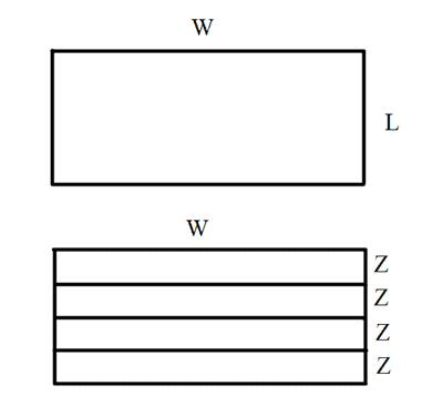

LW is original rectangle. Divide it into a finite number of subrectangles (4 are shown, but any number could work), each with a length Z, which is an integer value. Therefore...
L = Z + Z + Z + Z
L = 4(Z)
Length of original rectangle must also be an integer value.
If you divide it like that. You have to show that there is no possible division for non-integer values. You can't do that by picking a single one and showing that this specific one does not work.
The problem is not as easy as it might look.

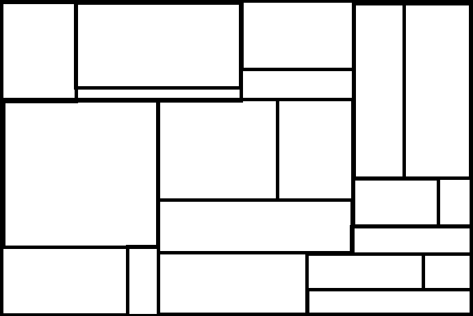

The subrectangles might form a quite irregular pattern, like the attached one. All that is given is that each subrectangle has a side which has integer length. It could be the horizontal side, the vertical side, or both, and this might differ between the subrectangles.

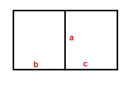

First lemma:
Given a rectangle which consists of two smaller rectangles, and they satisfy: "at least one side with integer length", thus, the big rectangle also satisfies this condition.
Proof:
a is an integer ⇒ the big rectangle has at least one side with an integer length.
a is not an integer⇒ b is integer and c is integer ⇒ b+c is an integer, the big rectangle has at least one side with integer length.
q.e.d

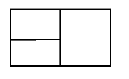

Second lemma:
Given a rectangle which consists of three smaller rectangles, as showed in the sketch, and they satisfy: "at least one side with integer length", thus, the big rectangle also satisfies this condition.
proof:
Use the first lemma twice.

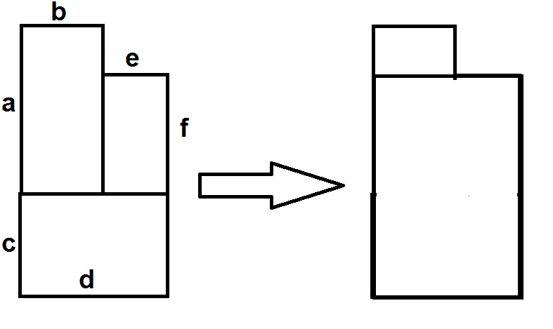

Elongate bd to h.
Let abcd cefg be rectangles with an integer side. (assume ab is the integer, if ac is the integer, it is really the same, just rotate the sketch)
Then, cghd and dhfe also have an integer side.
proof:
ab is an integer⇒ cd is an integer⇒cghd satisfies the lemma.
If ef is an integer ⇒ dhfe satisfies the lemma.
ef is not an integer⇒ ec is an integer ⇒ ec-dc is an integer ⇒ed is an integer⇒dhfe satisfies the lemma.
q.e.d.

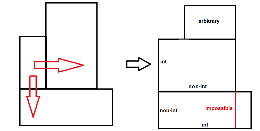

Let's examine Erland's sketch:
First, we should apply the first and the second lemmas to simplify the sketch.
We get:
Wow! it simplified very well! each of these rectangles has an integer side.
Here is where the third lemma comes to save us.
Let's apply it to the middle rectangle. (I will show the option where the horizontal lines are the integers, but it works also to the vertical lines.)
Now, it's piece of cake...
Just use the first and the second lemmas again, and you can prove that the original rectangle has an integer length.
Let ac=1, ab=pi, cg=pi, gf=4. Splitting it into three rectangles fails, as you create a pi squared rectangle, no matter how you rotate it.
I was at that point as well.
There are other ways to rearrange rectangles, but you need a proof that you can simplify every possible pattern with these operations, and that is far from trivial.
Actually, what I meant is that we can't say which of the sides is an integer. But the proof is the same, and it is enough to show that it works for one side, since we can always find in the rectangle:
I hope it is more convincing.
I think I should have added this rule too: d is integer
