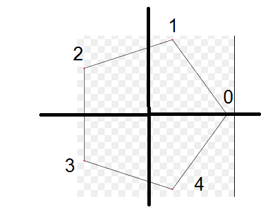

The probability that the center of polygon lies in the interior of the triangle that is formed from the three randomly chosen vertices is n+1/ 4n-2. (2n+1 is the number of the vertices.)
In order to evaluate the probability, I found how many options of triangles there are and how many triangles don't satisfy the requirements.
To make explanations easier I will base on this sketch:
Regular heptagon with vertices labelled 0 to 4 and the centre marked by the crossing of the axes; vertex 0 lies on the positive horizontal axis, with vertices 1 and 2 above and 3 and 4 below.
please notice: the 0 point will be always on the horizontal axis, and the center in 0,0
To figure out how many triangles can be created, one has to understand that the quantity is equal to the number of combinations of 3 vertices that are ordered by size (with no repetitions)
for instance: (0,1,2) is ok but (4,3,5) and (3,3,5) are not.

Let's find the number of triangles that don't satisfy the conditions:
Since there is a symmetry( a line from each point 0, 1, 2, 3, 4), it is enough to find how many triangles don't cross the symmetry axis (and therefore the center is not in the triangle). In this example triangle (0,1,2) is above the symmetry line 0' and the only triangle that the center is not inside it.
How many triangles do we have like (0,1,2)? just as much as the amount of symmetry lines (5).
More generally, if there are 2n+1 sides, the symmetry line 0' passes through "n+0.5" point. The closiest point to "n+0.5" is n, of course, or 2 in the pentagon. The question is how many triangles are there in the general situation?
Let's look:
The first point must be 0. The next one could be one of these: n, n-1, n-2, ... ,2, 1
If we choose point 1, so there are left n-1 points bigger than 1 to select. 2 - n-2 3- n-3 ... for n there is no point.
Thus, we get: n-1 +n-2 + n-3 + ... +1 options for triangles, or put it another way: (1+(n-1))(n-1)/2 = n(n-1)/2 since there are 2n+1 symmetry axis, we obtain:
n(n-1)(2n+1)/2
Putting it together
p=1- (n(n-1)(2n+1)/2)/(n(2n+1)(2n-1)/3)= 1- 1.5(n-1)/(2n-1)= n+1/ 4n-2

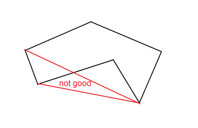

QuantumQuest said:
any polygon
This is actually not accurate, any polygon except Concave polygon.
No, it is absolutely accurate. We talk about polygons in plane i.e. 2-d.
Concave pentagon with vertices joined by black lines, with two red diagonals drawn across it and the red label "not good" beside them.
This is what I meant saying "Concave polygon".
"You still introduce a fourth point that is not necessary." - just an example to visualize the formula I get.
ddddd28 said:
