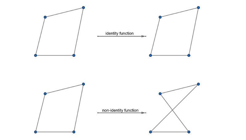

There is an interesting definition that can help.
A rigid set is a set with the identity function as its only automorphism.
May I have an example?
See the images below.
Both functions are automorphisms.
Now I see what you mean. Then the same question as stated in #14
