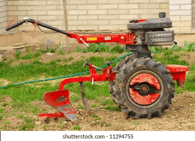

I made my work on papers now it needs sometime to transfer it to a document. firstly, the purpose of developing a model is to design a controller after getting the mathematical model of the tractor. what i need to control is the speed of the tractor and its stability during ploughing process with the assist of human force involvement (semi-autonomous) . so I'm imagining a two wheel tractor with a plough on the rear and a chassis just above the wheels and extended a little to the front, and with handle to make the human able to control it. The forces that interact with the systems are traction force on the wheels, rolling resistance, plough draft force (with the soil) and the human with hand force. i need to driving it a straight level over soil and assume a straight shaft.

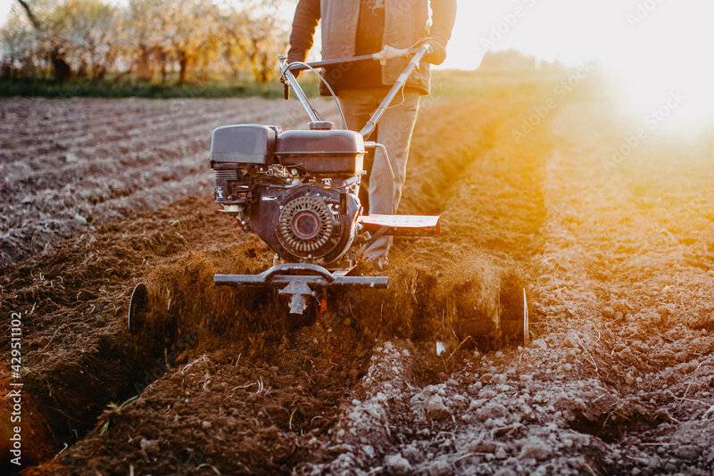

Sorry, do you mean something like this?
https://www.abposters.com/work-with...home-farm-plow-the-soil-for-sowing-f429511102
yes, but it has a wheels and a plough not only the helical plough, like this:
so i need to make the model taking into account all exerting forces, can you please help?
