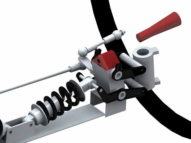

Well, at the moment I am busy with a 3 wheeled HPV. 2 wheels in front en 1 rear wheel. And I have a diffuculties with my powertrain. I want to use the CV-joints, but I don't know wether there available that small. This is maybe a bit off topic. But perhaps you know a retailer who sales cv joints?
Thanks!
The cv-joint must connect the red parts
I know of no source for sub-auto sized CV joints. If I am unable to locate a suitable supplier / manufacturer I will have to make my own.
