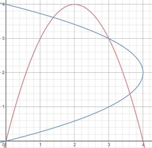

  • Graph on a grid with x and y axes from 0 to 4, showing a red downward-opening parabola peaking at (2, 4) and a blue curve starting at (0, 4) that sweeps right to a rightmost point near (4, 2) and back to (0, 0); the two curves cross near (1.4, 3.6) and (3, 3).
  • Graph on a grid with x and y axes from 0 to 4, showing a red downward-opening parabola peaking at (2, 4) and a blue curve starting at (0, 4) and sweeping right to a rightmost point at (4, 2), crossing the red curve at (3, 3).
  • Graph on a grid with x and y axes from 0 to 4 showing a red parabola peaking at (2, 4) and a blue curve starting at (0, 0) and (0, 4), crossing at (3, 3) and (3, 1), and bulging to x = 4 at y = 2.
  • Graph on a grid with x and y axes from 0 to 4 showing a red downward-opening parabola peaking at (2, 4) and a blue curve starting at (0, 4) that bends to the right, reaching x = 4 at y = 2, and crossing the red curve near (3, 3).
  • Graph on a grid with x and y axes from 0 to 4 showing a red downward-opening parabola peaking at (2, 4) and a blue curve starting at (0, 4) that bends to a rightmost point at (4, 2) and returns to (0, 0).
  • Graph on a grid from 0 to 4 showing a red downward-opening parabola peaking at (2, 4) and a blue curve from (0, 0) to (0, 4) bulging right to about x = 4 at y = 2.
  • Graph on a coordinate grid with x and y axes from 0 to 4 showing a red downward-opening parabola peaking at (2, 4) and a blue curve starting at (0, 4) and sweeping right to a rightmost point at (4, 2) before returning to (0, 0), with the two curves intersecting near (1.4, 3.6), (3, 3) and (3.6, 1.4).

"needing to solve a polynomial of order 4: y = − x ( x − 4 ) = y ( y − 4 ) ( − y ( y − 4 ) − 4 ) , or − y 4 + 8 y 3 − 20 y 2 + 15 y = 0 . Since such a task is well out of my mathematical reach, "It is not beyond your reach when you already know, as you do, two of the solutions!
True enough - should have seen that one! Perhaps a little bit 'knee jerk' to send it off to WA!
Ok - better give it a go then!
$$y=-x(x-k) ; x=-y(y-k) \implies
y=y(y-k)(-y(y-k)-k)$$ $$ \implies
-y=y(y-k)(y(y-k)+k)=(y^2-ky)(y^2-ky+k)$$ $$\implies -y=y^4-ky^3+ky^2-ky^3+ky^2-k^2y$$ $$\implies 0=y^4-2ky^3+2ky^2-(k^2-1)y=y(y-(k-1))(y^2-(k+1)y+(k+1))$$ From which we obtain the two solutions at (0;0) and (0;k-1). The discriminant of the third factor quadratic is $$(k+1)^2-4(k+1)=k^2-2k-3=(k-3)(k+1)$$ in accordance with the WA solution.
