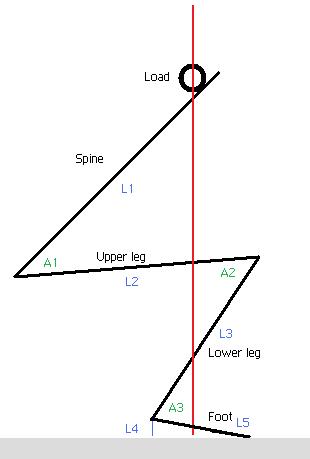

My problem is one of biomechanics. One of the primary exercises I use is the barbell squat. Holding a loaded bar on your upper back and squatting down means that the skeleton of your body moves, the joints move and the bones and muscles transmit force through them down to the floor. I am looking for a mathematical model which can take the various measurements of the body and calculate the angles the joints are making with each other, the forces that are being transmitted through each member and the moments that exists around the joints.
Here is an image showing the position of the skeleton in the squat.
The load is positioned on the upper back, and L1 represents the length from the load to the hip joint. L2 is the length of the upper leg. The lower leg of length L3 pivots at the ankle and L4 represents the height of the heel on the shoe, which serves to lift the heel of the foot off the floor slightly. L5 is the length of the foot and the load must always remain on the centreline of the foot, as represented by the red centreline. The load always moves vertically on this centreline. The only inputs to the calculation are the lengths L1 to L5, and the size of the load in kilograms.
A1 is the angle formed between the spine and the upper leg at the hip. A2 is the angle formed between the upper leg and the lower leg at the knee. A3 is the angle formed between the lower leg and the foot at the ankle. What are these angles for any lengths of L1 to L5?
The load is stationary in this position, so the system must be in equilibrium. The load must be being transmitted to the ground through the bones. Given the size of the load, the various lengths L1 to L5, and the angles they are creating, what are the forces in each segment and what are the moments being created around each joint?Im looking for a set of equations that can describe this model which I can plug in various lengths of L1 to L5 and a size of load variable.

I'll do the easy one first:
M@A3= P×L5×cos(A5)
where
P = Load
A5 = Arcsin(L4/L5)
assuming we can ignore the weight of the lifter
You've picked the only right angled triangle there haven't you lol.
So you're working out what A5 is (a new label representing the angle between the toe end of the foot and the ground), by taking the inverse sine of opposite (L4) / hypotenuse (L5), which only works for this bit because its a right angled triangle.
Then to calculate the moment you're taking the load, P, multiplying it by the length L5 and the cosine of A5 which is to somehow get the right vector is that correct?

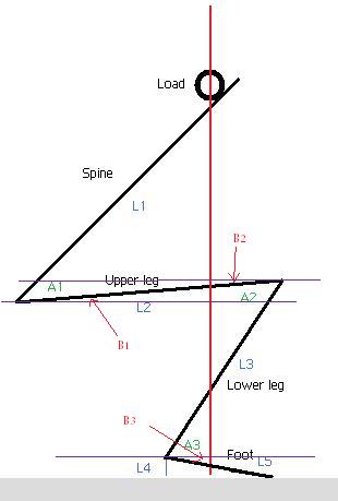

It might help to communicate better if you draw a horizontal line through each joint on your sketch and label the angle each member makes with this horizontal line.
Like this:
Ive labeled the angles between the horizontal lines as B1, B2 and B3.
Still don't understand what A3-A5 means.
Yes, that looks good. Hopefully you can see all the right angled triangles now.
Also, it should be clear that B3 = A5, yes?
I can see that B3 = A5 yes, but how does that help figure out A3?
Im still not really sure on the right angled triangles. Are you saying that one of them might be if a line is dropped from the knee joint vertically down to the horizontal line above the foot? In that case L3 is the hypotenuse (side C in pythag), but the length of the hypothetical sides A and B is still unknown, and the angles A3 and A2 are still unknown so I don't see how that helps things.
But the angle A3 - A5 makes the right angled triangle for L3, n'est pas?
Yes I can see that, but we don't know the value of A3 in the first place so how can we numerically calculate A3 just knowing L3, even if it is a right angled triangle. We still only know the numerical value of length L3 unless I am missing something?
Using my previous numbers, L5=0.2m, L4=0.02m and let's say L3=0.5m.
So we can work out A5 = B3 = Arcsin(0.02/0.2) = 5.7 degrees.
So we then know that L3 = 0.5m, and that A3-5.7 degrees = some angle which we still can't calculate.
