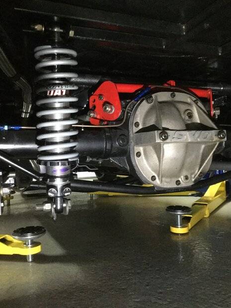

Hi , most rear suspension 4 link brackets mounted on the rear end housing are centered or slightly forward of the rear axle centerline . Why ? And what are the effects of moving the mounting points forward 2”,3”,4” forward ? Thanks for the help .
As you put the connecting points away from the centerline, you create a moment under lateral forces. This moment will contribute to increasing the stresses and deformations of the links, thus requiring stronger components and inducing more and more [undesired?] steering to your axle.

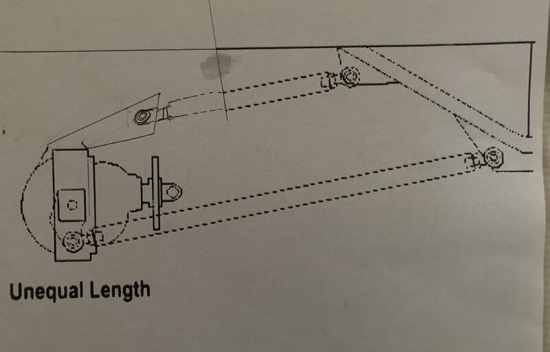

Agreed with everything you’ve stated . Again I should have been more specific . The upper control arm pivot point is not centered on the rear axle but rather 2” in front . What would be the effect of the upper control arm mounting point 2” 3” 4” forward of the rear axle launching a drag race car and assuming all I/C measurements and anti squat % is in reasonable range. Thanks for the response
B565 said:
But still unclear how moving the hole 2” , 3” forward of axle centerline would affect the dynamics of the launch on a Drag Race car .
It is still unclear how your connection point is moving with respect to the other connection points. Does it change the distance between those points? Does it change the link angles with respect to the chassis? All of that matters more in my opinion than simply the absolute position of a single point.

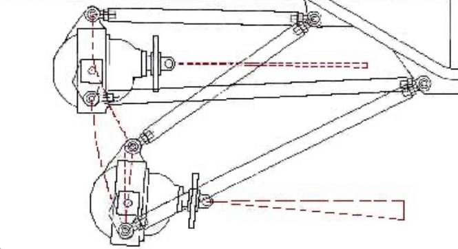

This will affect the anti-squat of the vehicle. And if the anti-squat is anything but 100%, the links will move and most likely change the amount of anti-squat. One important objective you want to achieve is smoothness in the motion, i.e. nothing suddenly stops or binds.

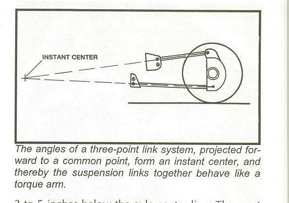

I suggest you read Race Car Suspension class in this mechanical engineering forum. pay attention to the index and look up 3rd link posts and Rear end Instant Center posts. I cover a little on 4 link too but is floater type for dirt cars. Also much on anti squat. itis in index too.
Instant Center - we want the angles of the stock 4 link to form an Instant Center (IC) as far forward as possible. This longer lever cushions the acceleration when the tires hook up. Too short an IC distance means we have a lot of angle change on both sides and the car will be real darty when you nail it. Longer is better and gives the driver more control because you don't have a lot of angle change as the shorter IC has.

B565 said:
Hi , most rear suspension 4 link brackets mounted on the rear end housing are centered or slightly forward of the rear axle centerline . Why ? And what are the effects of moving the mounting points forward 2”,3”,4” forward ? Thanks for the help .View attachment 334021
I’m fully aware of how the 4 link works Im asking what would the effects be with the diagram bellow . The pivot points on the rear end are always centered or slightly in front of the rear axle .

If the pivot points give the same I.C. location (links have the same angle), then there is no advantage initially. the shorter upper arm will impose more radical changes in the geometry as it moves, which you may want or not (most likely not).
But if you only set the pivot point forward as in your first image, assuming you keep the same locations for the I.C. and the other pivot points, it is pretty obvious that once extended as in your second image, the pinion angle will be much bigger - up to a point I doubt it would not cause problems. The shorter length of the upper link will most likely pull the axle forward as the suspension is extended, causing the driveshaft to bind.
Just redo the second image with the modified pivot location and you will see the differences as easily as one can explain here. Remember that the axle on your drawing can be replaced by a single link going from one pivot point to the other. Add a straight, perpendicular, line for the pinion and see how the angle and location change. If the angle between the driveshaft and the pinion is not the same as the one between the driveshaft and the transmission output shaft, or if the driveshaft length varies more than what is allowed, you will be in trouble, and the geometry of your suspension will be the least of your problem.
