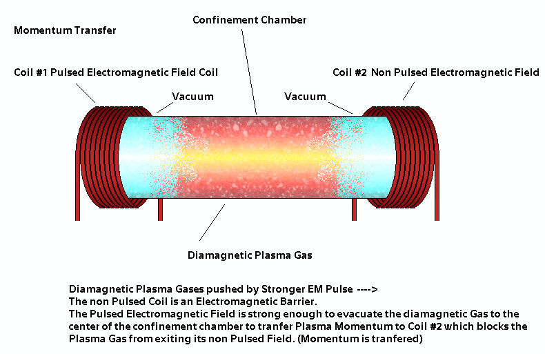

Could something like this be used for a momentum Tranfer in Space Ships?:bugeye:
If so, Then how could we improve upon it?
If not then kindly disregard this post.

I can't tell from the picture what the thing is supposed to do...
But unless you dump mass, you're not going to get any momentum imparted to the spacecraft .
[tex]\Sigma_{i=0}^n m_i*V_i=0[/tex]
or, momentum is conserved

It probably wouldn't work, but this was the plot.
1. Coil #1 fires off an EM Pulse that compresses the Diamagnetic Plasma Gas towords Coil #2 which prevents the Gas from Exiting, The Field from Coil #2 acts as an EM Barrier causing the Plasma Gas to be blocked which would probably force the Momentum of the Gas to be transferred to the Field Barrier of Coil #2, Coil #1 Fires off a very Rapid Strong EM Pulse that expands rapidly then is turned off until the next firing Pulse Charge is restored, The Gas will flow back to Coil #1 via Vacuum Suction then Coil #1 is refired with as many Joules of energy possible to recompress the Gas back to Coil #2.
I was hoping that the Compression and Decompression of the Gases Velocity difference, If any, Would cause a momentum transfer difference to make the unit travel in a linear direction in a Zero Gravity environment.
I had in mind that Equal and opposite forces may cancel the Momentum transfer and be conserved but I thought I would ask about it before throwing it out the window in case it had any potential.
Thanks for your time.
When coil#1 pushes the gas to the right (towards coil#2), it must recoil to the left. When the momentum of the gas is absorbed by coil#2, it recoils to the right.
You've designed an oscillator, not a propulsion drive.

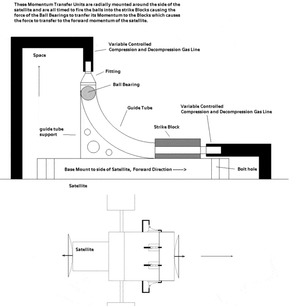

Another thought on momentum transfer to add littles bits of momentum over time.
Would something like this work?
There is an additional zoom after maximizing the page to sharpen the image, Hover mouse over the image to get the zoom button to appear.
The ball bearings will impart momentum to the circular tube in the opposite direction to travel, since they are accelerated - change in direction and presumably with some change in velocity.
Think of the components of velocity and the centripetal force in the circular track.
And, please don't get discouraged.
Intuitive : your designs suffer from the fundamental flaw that momentum conservation applied to the entire system (drive + craft) prevents it from getting anywhere unless there is momentum ejection out of system. This is what enigma tried to bring to your attention.
In other words, you are trying to power a sailboat with an onboard fan.
