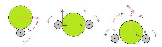

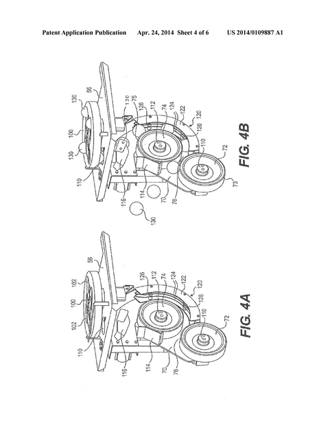

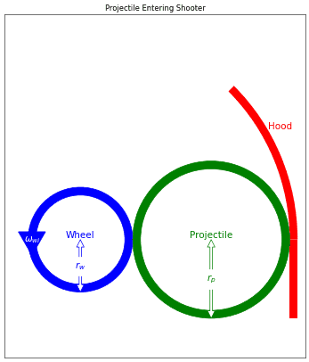

There are terminology problems here. You need to provide an annotated diagram or picture of the device you are discussing.
sure thing, here are some videos/pictures of hooded and linear flywheel shooters:
linear:
hooded:
notes: these are for ball only, but for linear shooters you are more then welcomed to treat it as a torus or disk as well (for pictures/videos on that just look up FRC 2024 and you will find tons of flywheel shooters)
hope this is helpful.
