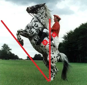

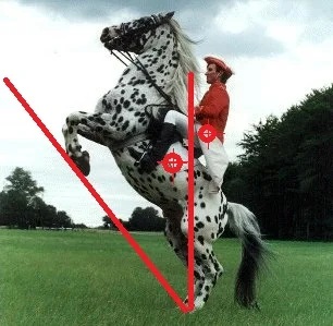

Let's assume the horse-rider assembly shown in the attached diagram is in static balance while the horse is rearing (not falling forward or rearward for an instant).
For that to happen, the horse-rider's combined center of mass must be located along the represented vertical line starting at the point of contact of the legs with the ground.
That position should be the limit, beyond which the horse-rider will fall backwards.
The balance sense of the horse should be clearly indicating that fact to its brain.
The represented slant line running between the front and rear legs indicates the maximum slope of the hill, which is far from vertical.

No. The back legs oppose most of the weight, the front legs counter the torque of the line through the CofM and the back hoofs.
The horses head and the rider are both leaning backwards to maintain balance on the rear legs. The slope can be significantly greater than you show.

Thank you for this picture. The angle of the diagonal line seems to be close to the angle of the slope Tigger and I went down. He put his right rear foot back and I leaned forward as far as I could. The Center of Mass of a horse on level ground is in the chest, below the withers. From what I can tell from your picture, the
Center of Mass shifts aft when the horse is at an angle. So, when I leaned forward, did our combined Center of Mass shift forward? The result was Tigger's front feet came down and he had ground contact. Was that due to the additional weight on his front or due to a shift in the Center of Mass?
Your shifting forward may have been counterproductive. That action, while in progress, would have created a torque tipping the horse backwards.
From a standing position, arms down, lean a little backwards so you feel in danger of falling. Swiftly rotate your arms, keeping them straight, forwards and upwards, to be straight up. Fall prevented.
Now try the other way. With arms straight up, lean forwards. Bring the straight arms down forwards, fast, but only to the horizontal position. Despite their mass now tending to tip you forwards, the action of swinging them down kept you upright.
Tigger may have achieved the recovery despite your action by swing his forelegs up and forwards.
I have represented the horse's center of mass with no rigor at all, since I don't know where exactly it may be.
What I tried representing was that both independent and separate centers of masses (horse's and rider's) create a combined imaginary center of mass, which actually works as a unique CM of the system formed by both bodies.
Yes, your ability to locate your CM forward helped the combined CM to be relocated forward, which moved the vertical vector representing the combined weight forward and ahead of the point of contact of the rear legs, which induced a counterclockwise moment or torque, which helped the front legs to step on the hill.
As @Baluncore has explained above, and as it can be observed in the animation, the animal instinctively stretches its neck and relocates its head forward, trying to achieve a similar forward relocation of its CM and to induce that torque or moment.
