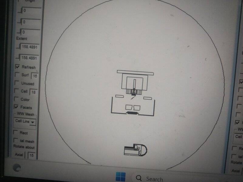

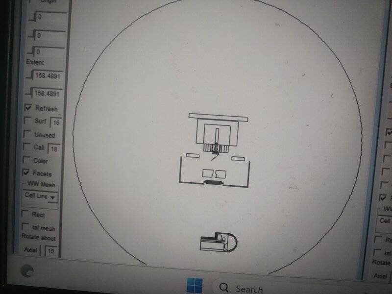

Hello, I doing my thesis, I'm beginner in MCNPX. I want to ask about transformation in MCNPX, I want to transform this head phantom in inside and outside field ( radiation using LINAC from face to ear) in angle 90° and 270 °. Can anyone help me to solve this problem with transformation code?

ifa23
Here it is. Before I write this problem to forum. i have tried but got the wrong transformation, head phantom has rotate to right/left side like this not in inside/outside, please check my code, i guess wrote the wrong code in TR code

#8
ifa23
Ok, thank you for the explanation. I have learned matrix rotation before that. So, if i want to rotate the head phantom in 270 degrees, the rotation matrix will seems like that right?
Code:
[0 1 0]
[-1 0 0]
[0 0 -1]
the TR code
Code:
tr1 0 -100.595 -100.595 0 1 0 -1 0 0 0 0 -1
I have tried in MCNPX, but any error, the phantom not appear, may i wrong when doing rotation matrix?

#12
ifa23
Alex A said:
Ok, you have tried "tr1 0 -100.595 -100.595 1 0 0 0 0 1 0 -1 0" and that works as a left turn by 90 degrees?
Show me every step you did to get an anticlockwise 270 degree turn (a 90 degree turn right).
"tr1 0 -100.595 -100.595 1 0 0 0 0 1 0 -1 0" the code works as a right turn by 90 degrees ( in front of the screen). then i want to rotate this phantom turn left by 90 degrees (behind of screen), so if turn right by 90 degrees, eyes organ is visible, but if turn left by 90 degrees, eyes organ invisible. I have succeeded in turning the phantom 90 degrees to the right, but have not succeeded in turning it 90 degrees to the left (270). This file is the result of rotating the phantom 90 degrees to the right. I really hope for your help. Thankyou

#14
ifa23
OK thankyou, But the code you demonstrated is exactly what I want, let's say the code in the file is a 90 degree rotation to the left, I also want to make it 90 degrees to the right, the opposite of the phantom image of the file, how do I solve it? because I've tried changing the coordinates ( x y z) and changing the vector matrix but it still doesn't work, instead the phantom doesn't appear, I don't know what else to do.
