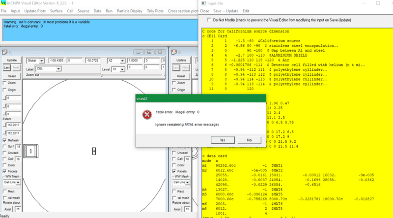

Thank you, Alex. I modified the source card and use the surface 80 as the source. But it shows fatal error, illegal antry 0. Nevertheless the code runs, but gives no output !!! If I define the source card as pos=0 0 0 , it shows no fatal errors, but the code does not run !

The problem you ran has
Code:
   42-       sdef erg=100 par=1 sur=80 ext=0 0 1.96 rad=0.47
 warning.  ext is constant.  in most problems it is a variable.
 fatal error.  illegal entry:  0
Running just 'sdef erg=100 par=1' should work as explained above.
Your e card is good but it needs to be e2 to match the f2 and they should be together, f2 first.
A minor thing, but erg is in MeV so 100 Mev is quite high for neutrons it does not need fixing now but your high value for the e card should probably exceed 100 to show everything.

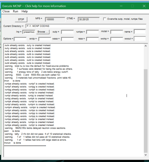

Hi dear, After modifying and running the code I got these output. Do I have any issues with my software?
You are not deleting your out files and run files. So your output file should not be called outp. It might be called outq or outa, or something else, I can't read the screenshot. Are you posting the newest file made by the program?

actually there was issues with my laptop , code runs here but did not produce any data. I run it to another laptop, it give me data, but that was not enough for getting spectra,
Ohhhhhh! I think you have an incorrect character, most probably in your xsdir file. The line should have "C:\Program Files (x86)\LANL\MCNPDATA" if that is where your cross section files are, but instead of C is something not ASCII, that causes MCNP to break and also gedit to break. It might be unicode.
So open your xsdir file, it should be in the same dir that mcnp is in and the first line should tell mcnp where your cross section files are. Edit that to make it correct.
