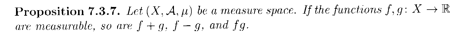

I need help with the proof of Proposition 7.3.7 ...
Proposition 7.3.7 and its proof read as follows:
In the above proof by Lindstrom we read the following:
" ... ... $$(f + g)^{ -1} ( [ - \infty , r ) ) = \{ x \in X | (f + g) \lt r \}$$
$$= \bigcup_{ q \in \mathbb{Q} } ( \{ x \in X | f(x) \lt q \} \cap \{ x \in X | g \lt r - q \} )$$ ... ... " Can someone please demonstrate, formally and rigorously, how/why ...
$$\{ x \in X | (f + g) \lt r \} = \bigcup_{ q \in \mathbb{Q} } ( \{ x \in X | f(x) \lt q \} \cap \{ x \in X | g \lt r - q \} )$$ ... ...Help will be much appreciated ...

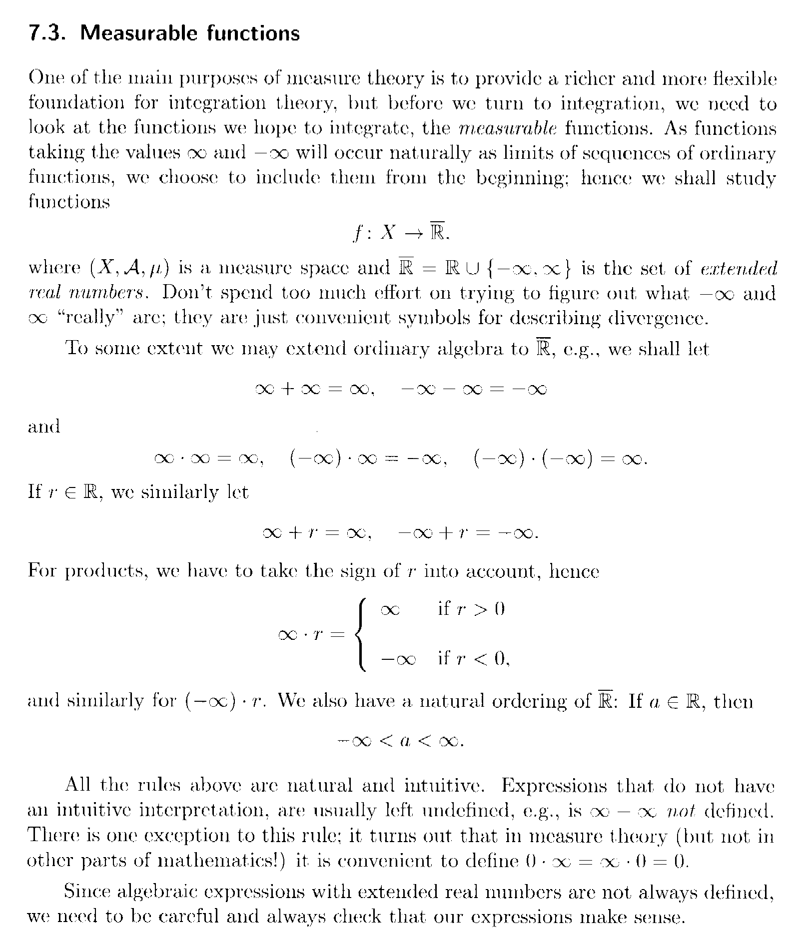

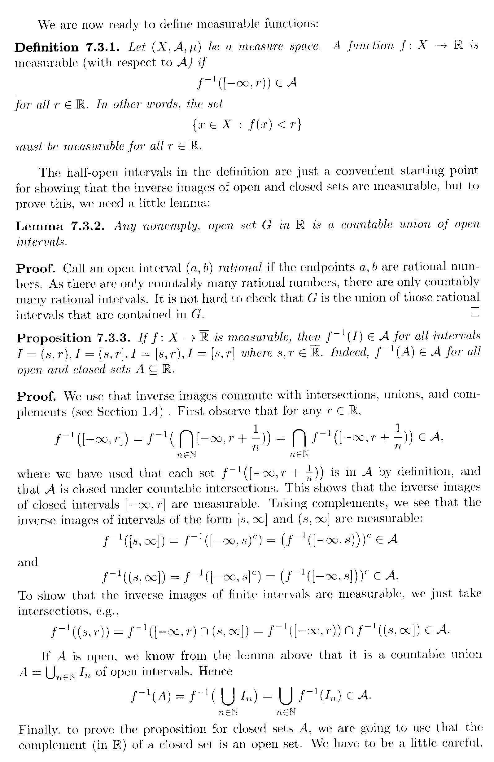

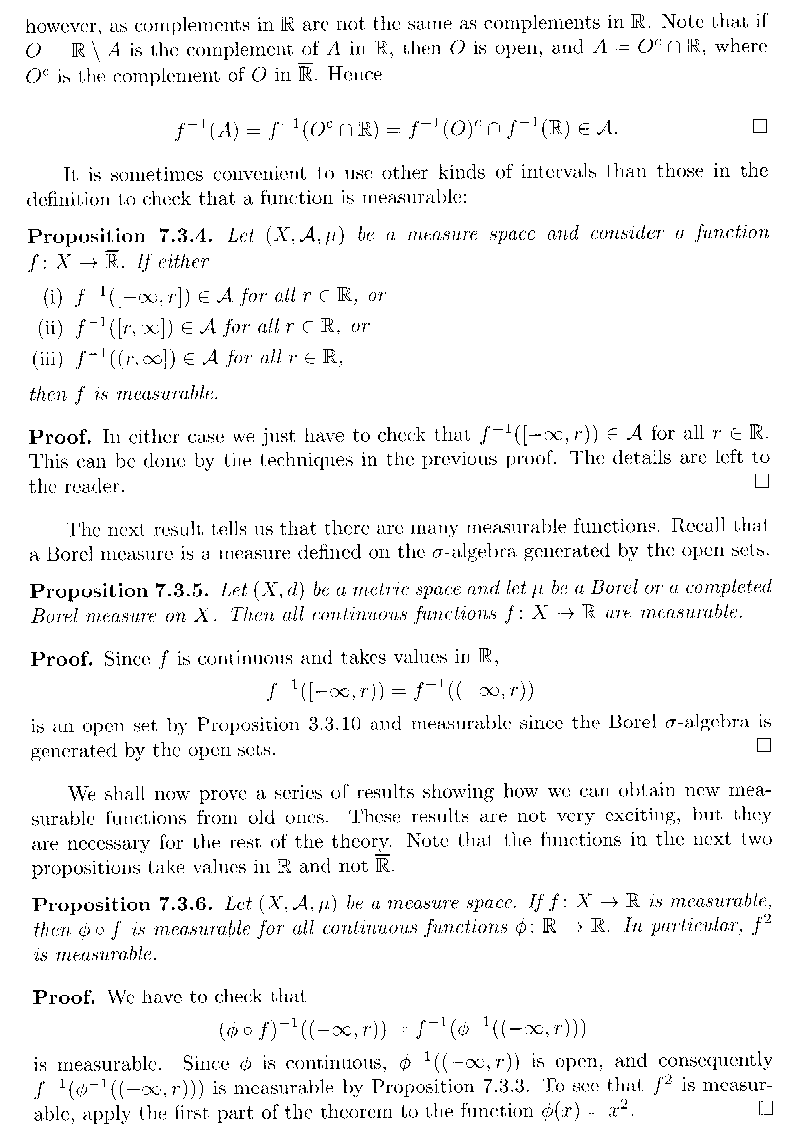

Peter=============================================================================================================Readers of the above post may be assisted by access to Lindstrom's introduction to measurable functions (especially Lindstrom's definition of a measurable function, Definition 7.3.1) ... so I am providing access to the relevant text ... as follows:
Hope that helps ...
Peter
