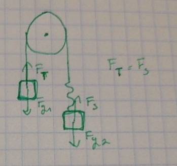

m1= 0,05 kg, m2= 0,03 kg, mass of spring is omitted. We look at movement after spring stopped vibrate. How long does the spring measure during the movement if not stretched spring measure 0,1 meter and if we use force 0,1N elongation measures 0,02 meter.
(sorry, English isn't my main language, I've never learn scientific words so I'm not quite sure if my translation is right)
I know the answer is 0,174 meter.
m1*a = m1*g - Ft (Ft is thread tension)
m2*a = Ft + Fs - m2*g
0,1 = k*0,02
k=5
Don't know what next and if it's even right.

Hym, I can solve problems when there is no spring. That spring is real problem since I don't know how to mark forces at that device. Is Fs=Fg? My friend tried to solve that without Fs but I'm not sure...

I'm not sure but aren't second mass applying force? Can't Fg be force of action and Fs force of reaction?

Well, because of mass 1 that system is moving to the left.
I think you have the right idea. Translation may be a little off. Because of mass 1, the force on mass 2 does not equal the the force of gravity on mass 2.
With that being said, because the spring is without mass it does not contribute to the acceleration of mass 1. The tension in the string, Ft , is therefore also the same force acting on the spring, Fs .
Likes Aireve

So...
0,1 = k*0,02
k=5
m1*a = m1*g - Ft
m2*a = Ft - m2*g
a(m1 + m2) = g(m1 - m2)
a = 0,2/0,08 = 2,5 m/s^2
Ft = m2(a + g) = 0,03*12,5 = 0,375 = Fs
0,375 = 5*x
x = 0,075 m
x+0,1 = 0,175 m = 17,5 cm
Is it correct?

Looks like it

But can I have one more question? How should I draw those forces at that picture? Should I draw Fs and Ft or only one of them? They should "touch" mass 2 or spring?

But I think that would be messy and overly complicated. I personally would only draw forces on objects with mass.

Right, I don't think I have to do that much.
To be 100% sure, it's ok?
Looks fine to me
