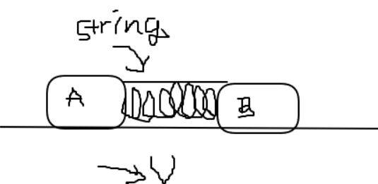

The air-track carts in the figure(Figure 1) are sliding to the right at 2.0 m/s. The spring between them has a spring constant of 140 N/m and is compressed 4.1 cm. The carts slide past a flame that burns through the string holding them together.
What is the final speed of 100-g cart?* I don't actually have a picture of this problem however it is a picture of two carts on an air track separated by a spring.
the left cart has a mass of 100g & the right cart has a mass of 400g.

Maybe I am misunderstanding the problem. Let's say the 2 carts are moving east at 2 m/s. When the string is burned, does the spring push one of the carts toward the north and one toward the south? Or does the spring push one of the carts toward the east and one toward the west?

Oh okay that's probably where my error is... there is a string holding the two carts together where the compressed spring is in the middle. once it passes the flame on the air track the spring will exert a force on the two carts.

Both carts are moving in the x direction initially. After the spring is released, are they both still moving only in the x direction, or does the spring cause them to angle off - one towards the north and one towards the south?
Edit: I'm trying to understand where the spring is positioned between the carts. Is it between their sides, or are the cars end-to-end and the spring is touching one car's front bumper and the other car's rear bumper?

Here is a little sketch

That's what I figured. Otherwise the answer could not have been 0.628 m/s. Which car is in front the heavy one or light one?
The lighter one.
Jk sorry! the heavier one is in the front.
sorry ah my brain is fried. the 100 g cart is behind the 400 g cart

But, when you solve a quadratic there are two solutions. It's the other one that is the right answer.
Edit: It turns out that one of the solutions is for the heavy cart in front and one for the heavy cart in back. At least I think that's the case. I didn't take time to verify it.

oh interesting so v2f = 2.34m/s?
Than oh yeah you get 0.628 m/s!

The velocity for the front car HAS TO increase and the velocity of the rear car HAS TO decrease. You defined Vf1 as the 100 g car in the back, so you know VF1 will have end up being less than 2.0 m/s.

It often happens that the equations do not encode all the information, so other solutions may appear. In the present case, the conservation laws produce the same equations regardless of the order of the carts.
