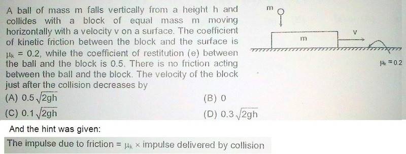

Hi all :biggrin:
Physics problem figure: a ball of mass m falls vertically onto a block of mass m moving right with velocity v on a horizontal surface, with mu_k = 0.2; answer choices A to D and a hint about friction impulse are printed beside it.
First of all,
can someone tell me how to get the eqn in hint? :redface:
And when i try solving it using the hint ...
of ball
(velocity of separation) = e(velocity of approach)
v' = e √(2gh) = √(gh/2)
let the time of collision is t
Impulse, IBall = Δp = m(v' - v) = m ( -√(gh/2) )
IBlock = μ IBall = -0.2 m√(gh/2)
IBlock = m Δv
Δv = 0.1 √(2gh)
But answer is (D)
But answer is (D)
Impulse, IBall = Δp = m(v' + v)
the answer D is correct!
Why would it be v+v' ?
both v and v' are opposite :confused:
the impulse is momentum after minus momentum before …
since v and v' are in opposite directions, that's mv plus mv' :wink:
OH okay!
so IBall = m(vfinal - vinitial) = m(v' - (-v) ) = m(v'+v)
I'm being careless again!
Thanks Tiny-tim and ashish
And one more help ...
where does the eqn in hint came from? i mean how do i find it ?
the rules for impulse are the same as the rules for force :smile:
So ... the impulse I on ball = Impulse I on block
and thus normal impulse from ground = Impulse of weight + Impulse I
Thus impulse of friction = μ (Impulse of weight + Impulse I)
But this is not the hint :confused:
impulse of weight = 0 :wink:
(impulse is over a very short time ∆t …
over that time, impulse of weight = mg∆t, which is infinitesimal compared with the finite impulses of collision)
I can agree with that but that's not a satisfactory answer :frown:
yes it is! :biggrin:​
check your book on impulse if you don't believe me :wink:
(gravity is always left out of impulse equations)
