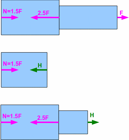

A graded steel cylinder AISI 1030 is connected to a wall and loaded with axial forces.
http://img542.imageshack.us/img542/3959/fbd1.jpg
Given:
F = 30 [kN]
d1 = 35mm
d2 = 20mm
Elastic Model: E = 2x105 MPa
Safely coeffecient: 2
Yield strength limit: 440 MPa
Required:
1) Describe the course of the internal forces along the beam and the course of the efforts.
2) Check beam for strength
3) Calculate the total distortion of the beam
Presumably
http://img831.imageshack.us/img831/533/neededformulas.jpg
Since I don't see a 3D drawing or references should I treat this problem like a 2D problem?
1) I presume they're asking for a free body diagram here:
http://img694.imageshack.us/img694/9629/freebodydiag.jpg

Hi Fp! :smile:
It is a 3D problem.
It's a side view of 2 cylinders.
Yes, I think so too.
But it puzzles me that they have an external force of F, and what appears to be an internal force of 2.5F.
If it is really an internal force it couldn't be that big, so I guess we'll have to assume it's an external force that compresses the leftmost cylinder.
Can you clarify that?

Hmm. Well, it's saturday and I have no contact to my teacher. What do you think it is likely to be? It sounds like what ur surmising it is.

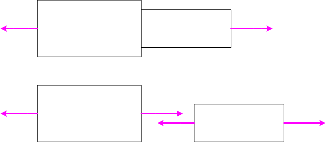

Is my second Free Body Diagram (based on SteamKing's reply) correct?

Femme_physics said:
Hmm. Well, it's saturday and I have no contact to my teacher. What do you think it is likely to be? It sounds like what ur surmising it is..
Since it's a basic exercise, I surmise that the left cylinder is compressed by 2.5F, and the right cylinder is expanded by F.
Otherwise it would really be too complex for a basic exercise in tensile stress.
Femme_physics said:
Is my second Free Body Diagram (based on SteamKing's reply) correct?.
No. Your first FBD was correct.
I'm afraid your 2nd FBD makes no sense to you.
(Did it make sense to you? :rolleyes:)
Note that the forces you drew there extend over the entire cross section of the cylinder.
Makes sense. We're just starting, and this is as far as I know non-calculus based.
(Did it make sense to you? )
I thought so! Glad you're here to set the record straight! :smile:

Wait, something is quite odd to me. When I isolate an object, aren't I supposed to draw all the forces acting ON THE OBJECT, as opposed to the forces the object is enacting on other objects that are not in the drawing?
That's why I didn't include include a 3rd vector.
Yes. That is right.
But I do not understand your conclusion.
In total there are 3 external forces: F, 2.5F, and Nx.
F acts on cylinder 2 and as a reaction, cylinder 1 pulls cylinder 2 back to the left.
The reactive force between cylinder 1 and 2, is that cylinder 2 pulls cylinder 1 to the right.
Let's try again. :smile:
Let's look *only* at F.
In the total picture, the wall exerts an equal but opposite power.
In the 2 separate FBD pictures, these forces have to balance out as well.
You seemed to have ignored 2.5F, though, am I right?
Sorry it takes me a while to reply sometimes. Appreciate your help. :smile:
Yes, I ignored 2.5F. :redface:
Perhaps you can add it?
Femme_physics said:
That's the problem. In the first shot it's easy, I know where to add it. But in the separated FBD, do I add it to both?
http://img407.imageshack.us/img407/3423/sepreal.jpg
The first shot is not in equilibrium any more!
Now it will accelerate into the wall!

Femme_physics said:
Well, since it's an external force, it seems to make sense. Still not sure what's wrong with my first FBD, though.
http://img710.imageshack.us/img710/6841/hmmmz.jpg
You added the forces F and 2.5F for cylinder 1.
I tried to explain to you that you should subtract them.
(And I though you might like it to set up and understand the force diagrams! :smile:)
There were 2 opposite arrows of equal length.
How do you know they're equal length?
But which one I subtract from which? Doesn't it depends whether the force extends the object or squash it?

Femme_physics said:
So...with respect to the vectors... I shouldn't have been adding the same vector to both FBD's?
I believe it does not matter, but don't take my word for it - just try it and see how it works out!
I drew them that way. ;)
The reason is that the one is the reaction to the other.
Since we're talking about a static problem (no movement), they have to cancel out.
Doesn't matter.
If the result is negative, it only means that the force apparently went the other way.
It won't matter for the calculations.
However, in your case you know which way is the largest force, so you can draw and calculate it right.
