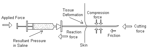

Hello ,
I'm trying to model the forces on a needle being inserted in a tissue. Needle tip penetrates the tissue surface and as it moves through the tissue, it experiences friction from needle-tissue interaction. Friction arises from the pressure exerted by surrounding tissue as it grips the needle. Assuming we have all the properties data for the tissue material, needle dimensions etc, how can we determine the pressure from the tissue ? [for friction force calculation]
  • Diagram of a needle inserted into skin: a syringe on the left labelled Applied Force and Resultant Pressure in Saline, with Reaction force, Tissue Deformation, Compression force, Friction and Cutting force arrows marked along the needle and at the skin surface.
U can use the formula Pressure * Volume equals Force*h(h is length of penetration)
That's true. But how would you calculate the pressure exerted by tissue on needle? I'm sure that we have to use the deformation / young's modulus or some another property of the tissue to find the pressure.
