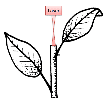

Can you please draw a schematic diagram of the sample and the laser hitting it, showing approximate dimensions of the sample?

This may be an overly obvious question, but do these plant stems change color as they mature?
Hi Chestermiller,
I haven't measured them but I would say the plant stems are about 0.5 mm to 1 cm in diameter (more mature plants are larger). The laser beam is ~3 mm. I made a diagram of the geometry of the setup:

Not in this case. I've looked at their spectrophotometric curves and the absorption characteristics are the same at the wavelength of the laser.

roam said:
Hi Chestermiller,
1. Are you saying that, in some cases, the diameter of the laser beam is greater than the stem diameter?
2. What is the length of the sample (since you are assuming the sample has finite volume)?
3. Over what depth would you say the laser is attenuated (or what is the absorption coefficient)?
1. Sorry, there was a typo in my post. I meant to say ~0.5–1 cm, so the diameter of the beam is always less than the stem diameter. Older plants are thicker so more of the sample resides outside of the beam.
2. The average length would be ~5 cm. Plants in early growth stages are slightly shorter.
3. Nearly all of the infrared light gets absorbed in the surface (epidermis of the plant). There is hardly any penetration into the tissue. It doesn't burn a deep hole like visible lasers do (i.e. not a volumetric absorption). The heat from the surface gets transferred to other areas only through conduction. I haven't calculated the absorption coefficient, but the absorptance is in excess of 95% according to the spectrophotometric measurements.

Hi Roam,
I looked over your photos of the C&J pages, and they don't seem relevant to your situation. So let's start over.
In doing modeling, the most important and basic principle is to START SIMPLE. There are numerous reasons for doing this. First, if you can't solve the simple problem, you will never be able to solve the more complicated version. Second, getting a solution to a simpler version of the problem gives you a quick start, and allows you to have an answer under your belt in short order. Third, the answer to the simpler version provides you with a basis of comparison for the more complicated solution to the problem.
So we are going to start out by first looking at solutions to the 1D problem, which assumes that the area of the laser beam is equal to the area of the stem. Then we can start looking at more complicated 2D version in which the area of the laser beam is less than the area of the stem.
For the 1D problem, we have already looked at the case where the stem is infinitely long, and obtained the answer for the maximum temperature rise given in post #22. This will also be the solution for the finite length stem at short times (where the heat has not had enough time to penetrate to the far end of the stem). Therefore, it provides us with a basis of comparison for the results that we will obtain for the finite length stem.
Next, let's solve for the 1D problem with a finite length stem. Let ##\theta (t,z)## be the temperature rise at time t as a function of z, and let q be the heat flux at z = 0 (for all times). The differential equation and boundary conditions for this situation are:
$$\frac{\partial \theta}{\partial t}=\alpha\frac{\partial^2 \theta}{\partial z^2}\tag{1}$$
##-k\frac{\partial \theta}{\partial z}=q\tag{2}## at z = 0
##-k\frac{\partial \theta}{\partial z}=0\tag{3}## at z = L
where k is the thermal conductivity, ##\alpha=\frac{k}{\rho C}## is the thermal diffusivity, and L is the length of the stem. The initial condition is ##\theta = 0## for all z.
For any time t, we can get the equation for the average temperature rise of the sample (over the length of the sample) by integrating the differential equation from z = 0 to z = L to obtain: $$\rho CL \frac{d\bar{\theta} }{dt}=q\tag{4}$$where $$\bar{\theta}=\frac{1}{L}\int_0^L{\theta(t,z) dz}\tag{5}$$The solution to this differential equation subject to the initial condition is: $$\bar{\theta}(t)=\frac{q}{\rho C L}t\tag{6}$$
At very long times, the solution to the differential equation and boundary conditions will approach ##\theta_{\infty}(t,z)##, given by $$\theta_{\infty}(t,z)=\bar{\theta}(t)+f(z)\tag{7}$$The next step in our solution is to determine the function f(z). If we substitute Eqns. 6 and 7 into our differential equation, we obtain:
$$\frac{q}{kL}=\frac{d^2f}{dz^2}$$Integrating this from z = 0 to arbitrary z (subjection of Eqn. 2) yields:
$$-\frac{q}{k}\left(1-\frac{z}{L}\right)=\frac{df}{dz}\tag{8}$$Note that this relationship also satisfies the boundary condition represented by Eqn. 3. If we integrate this again between z = 0 and arbitrary z, we obtain:
$$f(z)=f(0)-\frac{q}{k}z+\frac{q}{2kL}z^2\tag{9}$$
The constant of integration f(0) must be such that the average of the function f(z) over the interval from z = 0 to z = L must be equal to zero (since the average temperature is already ##\bar{\theta}##. This requires that ##\int_0^L{f(z)}dz=0\tag{10}##
From this, it follows that $$f(0)=\frac{qL}{3k}\tag{11}$$ and $$f(z)=\frac{qL}{3k}\left[1-3\frac{z}{L}+\frac{3}{2}\left(\frac{z}{L}\right)^2\right]\tag{12}$$So the asymptotic solution to this problem at long times is given by:
$$\theta_{\infty}(t,z)=\frac{q}{\rho C L}t+\frac{qL}{3k}\left[1-3\frac{z}{L}+\frac{3}{2}\left(\frac{z}{L}\right)^2\right]\tag{13}$$
And the maximum temperature rise at the boundary is given by ##\frac{q}{\rho C L}t+\frac{qL}{3k}##. Note that, as expected, these results depend on the length L (i.e., the volume of the sample V = AL).
So now, for the 1 D problem, we have obtained the solution for the temperature rise at very short times and at very long times.
I think I'll stop here an give you a chance to digest this. How do your experimental results compare to these results at short times and long times?

Before leaving the asymptotic 1D solutions at short- and long times, I'd like to add a few comments.
Our solutions for these cases can be reduced to dimensionless form by introducing the following dimensionless variables:
Dimensionless temperature rise = ##\theta^*=\frac{\theta k}{qL}##
Dimensionless time = Fourier Number = ##\xi=\frac{\alpha t}{L^2}##
In terms of these parameters, the dimensionless maximum temperature rise at short times and long times is given by:
$$\theta^*=\frac{2}{\sqrt{\pi}}\sqrt{\xi}\tag{short times}$$
$$\theta^*=\frac{1}{3}+\xi\tag{long times}$$
Next, let's see how large the dimensionless time parameter ##\xi## can get in your experiments. The thermal diffusivity of the stem is roughly 0.15 cm^2/sec, the heating time is about 10 sec., and the length of the sample is roughly 5 cm. So, for these values, the highest that the ##\xi## parameter reaches in the experiments is $$\xi =\frac{(0.15)(10)}{5^2}=0.06$$
Graph titled DIMENSIONLESS MAXIMUM TEMPERATURE RISE plotting dimensionless temperature rise against dimensionless time from 0 to 0.1. A blue line labeled LONG TIME ASYMPTOTE rises from about 0.33 to 0.43, and a red curve labeled SHORT TIME ASYMPTOTE rises from 0 to about 0.36.
The short time asymptote looks very much like the experimental data plot you presented earlier.
  • Graph titled DIMENSIONLESS MAXIMUM TEMPERATURE RISE plotting dimensionless temperature rise against dimensionless time from 0 to 0.1. A blue line labeled LONG TIME ASYMPTOTE rises from about 0.33 to 0.43, and a red curve labeled SHORT TIME ASYMPTOTE rises from 0 to about 0.36.
The difference in basic character between the calculated temperature histories from the model and the experimental data in post #5 (for the region above 80 C) strongly suggests that an important physical mechanism has been omitted from your model. Can you guess what that physical mechanism might be?

Evaporation (phase change) must be occurring at these temperatures. There will almost certainly be an interface between a dry region and a wet region within the pores of the stem. The leveling off of the curves in the middle region of the temperature-time curves is a strong indication of this, particularly since it is close to the boiling point of water.
