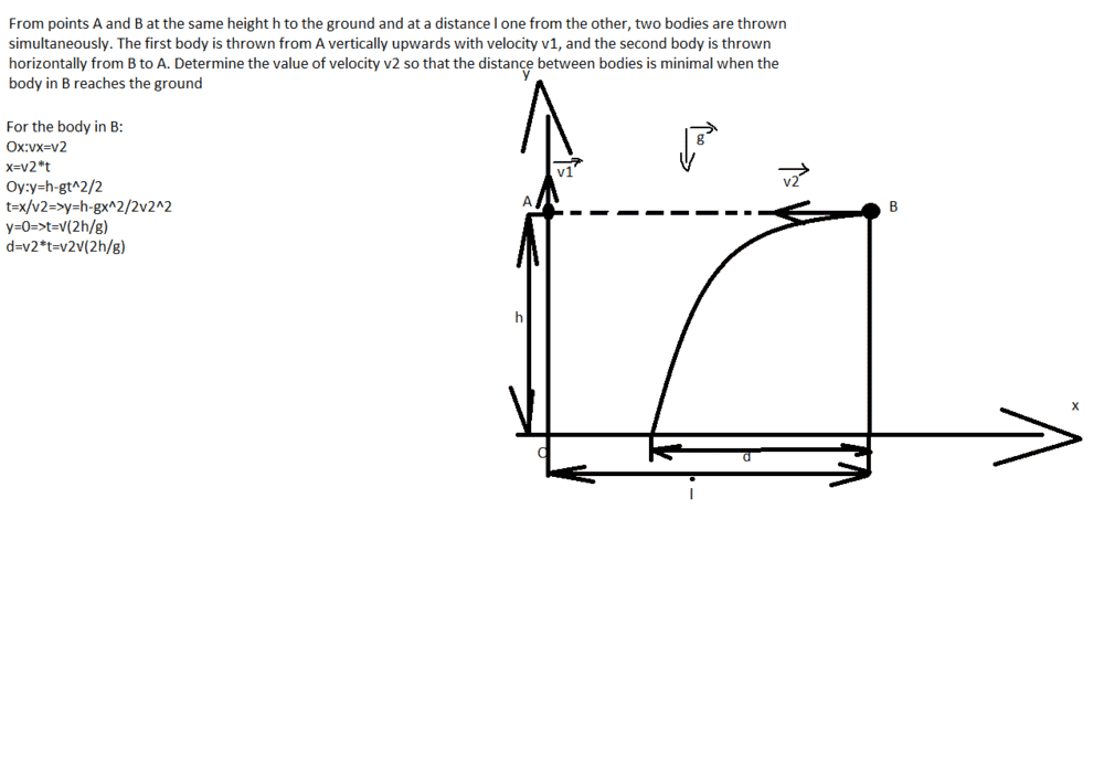

Find out the speed of the body B
From here you continue, which is the minimum condition, please
Baiatul122001 said:
Homework Statement:: Find out the speed of the body B
Homework Equations:: From here you continue, which is the minimum condition, please
We can only help with your homework, not do it for you. You should give this question your best attempt post again if you get stuck, showing us how much you've done.
So where is the body thrown from A at that time you calculated?
It's in the figure next to where I got stuck
I do not know if he has reached the maximum height or has continued to reach the maximum height
I meant as an algebraic expression.
Your v1 and v2 seem to bear no relationship to the actual problem statement.

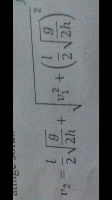

We have to calculate the speed v2 so that the distance between the two is minimal. The answer must be:
Let's suppose first that ##v_1 = 0##. Now, the two objects fall together and for a range of speeds ##v_2## the objects will come closest together when they both hit the ground. In this case, therefore, there is no unique solution.
There must be a minimum value of ##v_1## for there to be a solution.
Let's suppose next that ##v_1## is large. Object A is fired up at high speed and the point at which they are closest is at ##t=0##.
There must be a maximum value of ##v_1## for there to be a solution.

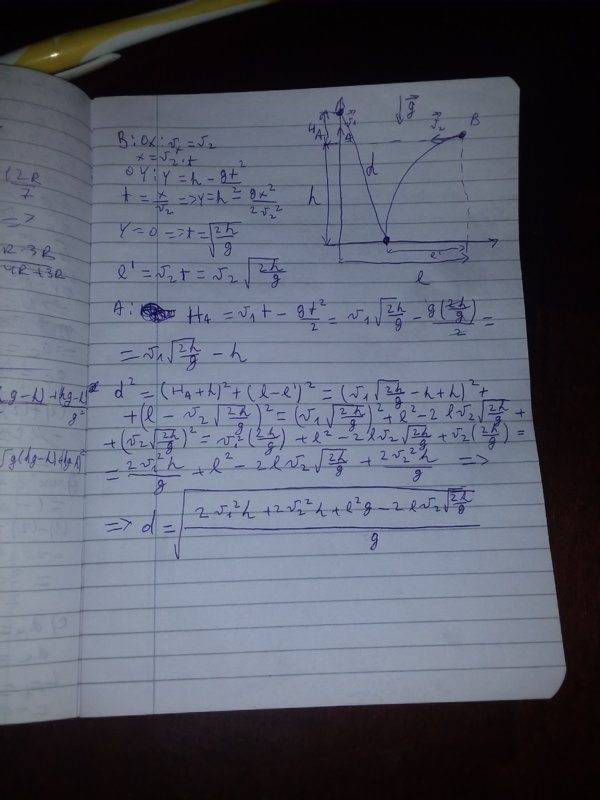

During t the body from A climbs: H=v1t-gt^2/2=v1√(2h/g)-h/g.
So the height at which the body in A when the one in B reaches the ground is H'=H+h=v1√(2h/g)-h/g+h=v1√(2h/g)+(-h+hg)/g.
The horizontal distance between the bodies at this time is D=l-d=l-v2√(2h/g).
Now we apply the Pythagorean Theorem to find the distance between bodies:L^2=D^2+H'^2=[l-v2√(2h/g)]^2+[v1√(2h/g)+(-h+hg)/g]^2=l^2-2l√(2h/g)v2+(2hv2^2+2hv1^2)/g+2√2v1√h√g(hg-h)/g^2+(hg-h)^2/g^2.
Consider the function f (v2) =l^2-2l√(2h/g)v2+(2hv2^2+2hv1^2)/g+2√2v1√h√g(hg-h)/g^2+(hg-h)^2/g^2 , do we calculate the minimum of the function?

During t the body from A climbs: ##H=v_1t-gt^2/2=v_1√(2h/g)-h/g##.
So the height at which the body in A when the one in B reaches the ground is ##H'=H+h=v_1√(2h/g)-h/g+h=v_1√(2h/g)+(-h+hg)/g##
The horizontal distance between the bodies at this time is ##D=l-d=l-v_2√(2h/g)##
Now we apply the Pythagorean Theorem to find the distance between bodies:##L^2=D^2+H'^2=[l-v_2√(2h/g)]^2+[v_1√(2h/g)+(-h+hg)/g]^2=l^2-2l√(2h/g)v_2+(2hv_2^2+2hv_1^2)/g+2√2v_1√h√g(hg-h)/g^2+(hg-h)^2/g^2##
Consider the function ##f (v_2) =l^2-2l√(2h/g)v_2+(2hv_2^2+2hv_1^2)/g+2√2v_1√h√g(hg-h)/g^2+(hg-h)^2/g^2## , do we calculate the minimum of the function?
##v_1√(2h/g)-h/g## cannot be right. The left hand term is a distance, the right hand term is time2.
Similarly I see terms (hg-h) later, which make no sense. You should always check for dimensional consistency.

Check how you got the h/g at the end of this:
I used the time obtained for the body from B to touch the ground and using the law of uniform rectilinear motion:H=v1t-gt^2/2=v1√(2h/g)-g[√(2h/g)]^2/2=v1√(2h/g)-g(2h/g)/2=v1√(2h/g)-h
Ahh, I was wrong the first time
As I wrote, always check your final equation for dimensional consistency. If it is wrong, backtrack ("binary chop").

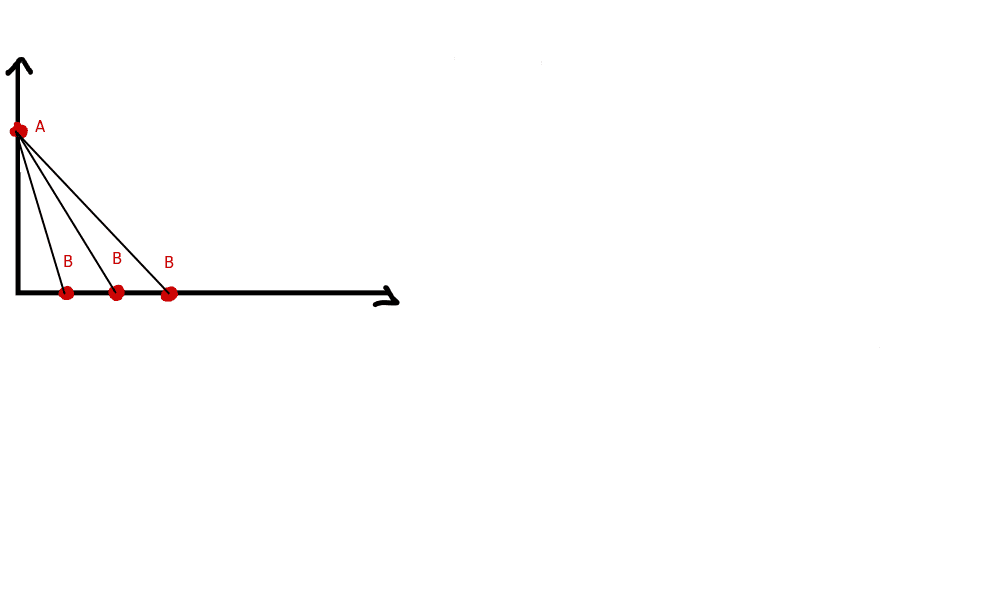

Suppose we are at ##t=\tau## when the body B reached the ground. How can you find ##\tau##?
Calculus approach:
How can you express the distance between both objects at that time, i.e ##d(\tau)##?
Your condition is on ##v_2##, so you want to minimize ##d(\tau)=f(v_2)##. What does that mean?
Algebra approach:
Think of it like this: B is on the ground, it doesn't matter where A is but it must be on the ##y##-axis. Where do you think B should be on the ##x##-axis for the distance between it and A to be minimum?
Is this the textbook's solution? Weird, my solution doesn't depend on ##v_1## at all, rather on ##h,\,g## and ##x_B(t=0s)##.
Maybe the textbook's solution is wrong
What is the book's solution?
Check post #9.
