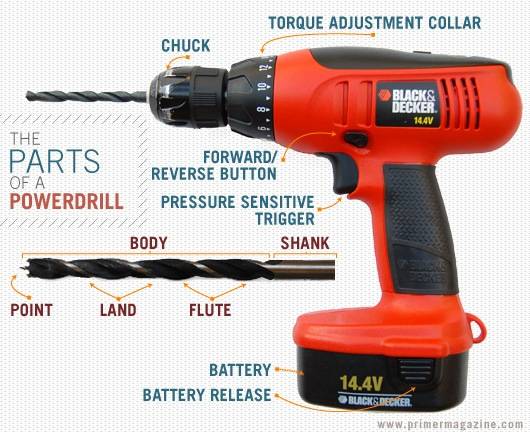

I have a geared DC motor taken from a hand drill. When I manually turn the internal motor, the drill bit rotates. This can be done in both directions. However If I try and turn the drill bit it does not rotate.
What is the mechanism called that achieves this?
My friend says it is a sprag clutch. But from what I have read a sprag clutch is used to only allow either clockwise or anticlockwise rotation, which is not what's happening here.
But is he correct?

What about when you turn the chuck by hand?
http://www.primermagazine.com/wp-content/uploads/2012/01/Powerdrill/Powerdrill_Diagram.jpg

It is often difficult to reverse the direction of energy flow through a reduction gear train.
If it has a permanent magnet motor then it will require some torque threshold before it starts to rotate. The torque that you must apply to the output shaft is scaled by the gear ratio. Use more torque.
Sometimes the friction of the motor or pinion bearings will be sufficient to prevent rotation of the motor from the output shaft of the gear train. That is called a “self locking” gear train. Remove any dry grease and use a more fluid lubricant on the motor and pinion bearings. Does that make a difference?

I don't have a wrench on hand at the moment. But I did accidentally apply a lot of force during an experiment today. We were running the motor with a fly wheel attached, ramping the speed up and down in both directions. We put it up to full speed, and then suddenly turned the power off. The locking mechanism kicked in and the drill and flywheel stopped dead, and almost broke my friends hand in the process.
Because of this I doubt that it is because I'm not applying enough force. There must be some sort of locking mechanism, I just need to know the name.

As I said in my reply to William Turrey, I doubt it's because I'm not applying enough force. I also doubt it is just friction, because that wouldn't be enough to bring the fly wheel to a sudden hault when the power was removed.
A brake-motor has a friction brake that is released only when power is applied to the motor.
What is the make and model of the drill your motor comes from?
What is the approximate gear ratio?

It is the http://www.ebay.co.uk/itm/Black-Decker-HP148F3-H1-14-4v-2-Speed-Cordless-Hammer-Drill-NAKED-BODY-ONLY-/400788172325. I am not sure what the gear ratio is, but when its in the high gear it has 36Nm torque.
I'll upload a video of me trying to turn the drill from both sides in a min. You can see in the video, in low gear, I can turn it from one end very easily, however I cannot turn it from the other end. I only use hand and not a wrench because I do not have one here, however I use quite a bit of force. Like I said earlier, the flywheel experiment applied lots of force and it did not turn.

There is no room for doubt in the analysis. You must verify the torque by using a wrench of some sort.
It is possible that the electronics stop the motor by applying a short across it's terminals when you release the trigger.
