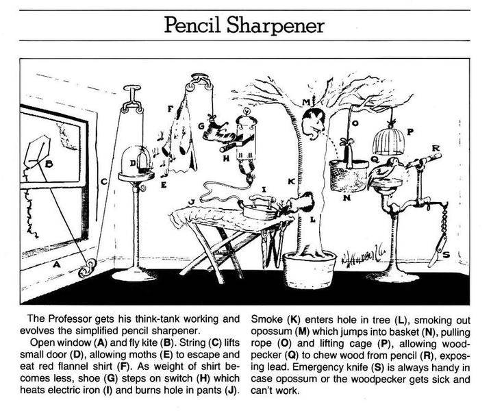

Maybe adapt something like this:
rube goldberg
