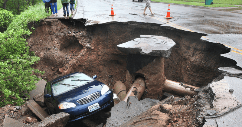

Can you say why you want to do this? Won't melting the permafrost under a concrete slab cause the slab to become a sinkhole?
https://www.cbsnews.com/news/10-sinkhole-facts-that-could-save-your-life/
