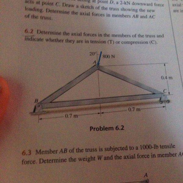

Determine the axial forces in the members of the truss and indicate whether they are in tension or compression.

Looks like you have reversed the components of the 800 N force. I didn't check the rest. Check your trig.
Are you sure? I've been a little confused on how finding them works. I know that if you rotate your triangle so the adjacent side goes up then you have to take cosines, but I was intending to continue the angle forward so that I wouldn't have to rotate the triangle. It would instead face the way it would've in quadrant 1 but in quadrant 3 (thus resolving sign and trig errors naturally)
Rather than trying to figure out what angle to use on a 360° circle, it's often less confusing to take the angle as indicated on the diagram, in this case 20°, and use that to figure out the components of the applied load. By using an angle of 250°, its easy to get an extra negative sign figured into the components.
In your calculation of the reactions at B and C, your moment equation is incorrect, due to having the wrong signs on the moment components produced by the applied load at A. Here, the moment due to the horizontal component of the load acts in the opposite direction of the moment produced by the vertical component. Your moment equation has both moment components acting in the same direction.
