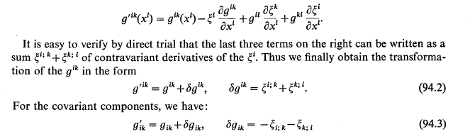

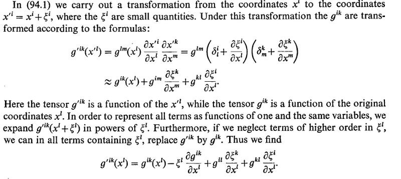

In the second volume, Field Theory, of popular series of Theoretical Physics by Landau-Lifschitz are given following equations as in attached file from the book. Here is considered metric change under coordinate transformation. How is the new, prime metric expressed in original coordinates is obtained as in (94.2). In right hand side of the equation right before (94.2) the last three terms is equal to Killing equations as it is said that could be verified by direct trial. What would direct trial like. I checked but got different results.
Use the metricity condition \nabla_{l}g^{ik} = 0 to express -\partial_{l}g^{ik} = g^{in}\ \Gamma^{k}_{ln} + g^{nk} \ \Gamma^{i}_{ln} . Substitute the above in the first term of the expression bellow \delta g^{ik} = - \epsilon^{l}\partial_{l}g^{ik} +g^{in}\partial_{n}\epsilon^{k} + g^{nk}\partial_{n}\epsilon^{i} . You will then see that the first term and the third term add up to g^{in}\nabla_{n}\epsilon^{k} \equiv \nabla^{i}\epsilon^{k}, while the second and the fourth terms give you g^{nk}\nabla_{n}\epsilon^{i} \equiv \nabla^{k}\epsilon^{i}.
Of course you obtain the same result, if you substitute \partial \epsilon = \nabla \epsilon - \epsilon \Gamma in the last two terms of \delta g = - \epsilon \cdot \partial g + g \cdot \partial \epsilon + g \cdot \partial \epsilon , and then collect the \Gamma’s terms to form \nabla g: \delta g = - \epsilon \cdot \nabla g + g \cdot \nabla \epsilon + g \cdot \nabla \epsilon . So, the metricity condition \nabla g = 0 implies and is implied by \delta g^{ik} = \nabla^{i} \epsilon^{k} + \nabla^{k}\epsilon^{i}.
