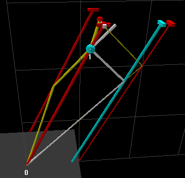

While I agree that the "details of the MM experiment are sometimes overemphasized", I don't agree that "a simpler way... is via dynamics".
Essentially, the MM experiment is a pair of arbitrarily oriented light-clocks whose round-trip times are compared.
Since we didn't have high-resolution clocks, it was clever to study an interference pattern... so the optical properties of the apparatus are featured in textbooks.
In my opinion, we don't need concepts of mass, energy, and momentum to see that the postulates of SR are in conflict with Galilean/Newtonian physics... kinematics is sufficient.

I didn't mean to imply that kinematics isn't sufficient, but I do suspect that many newcomers to SR (who may know little about optics, interferometers, or the ether hypothesis) might have an easier time with the dynamic argument I outlined above. Maybe not—what do I know?
The MM setup is indeed clever and historically important. On the other hand, Einstein's thought experiment is clever, too, and the prediction/confirmation of radiation pressure was also historically important.
