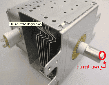

My 14 year old Panasonic Microwave Oven suffered a magnetron end cap failure
it commenced arcing and melted off a corner.
Photo of a 2M261-M32 magnetron with its cooling fins and a coaxial output connector on the left, and a circle marking a burnt-away end cap on the right.
I noticed it's not sealed, brand new ones have a hole in the end ...
so I'm wondering just what does the endcap do ?
I find plenty of descriptions of cavity resonance and the path of whirling electrons
but only brief mention of the endcap ..
Is the endcap part of the tuned antenna assembly , with dimensions that are critical?

or might i get away with soldering a copper pipe cap over the end ? With a hole of about same area as in the old endcap?
How hot does that part get ?
What is its purpose - just to short the end of the coaxial coupling ?
Thanks for a reality check,
link to instructive material appreciated.

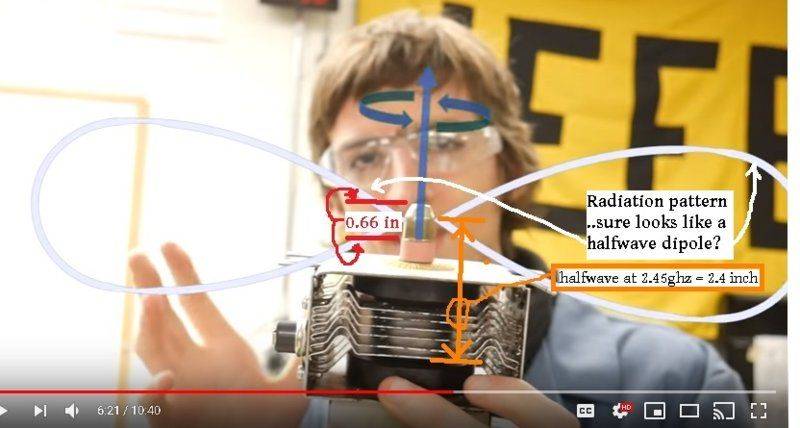

i found a "magnetrons for dummies" style Youtube that's sort of qualitative. Here's a snip I've annotated
extrapolating it to the point I'm on thin ice,
i surmise
Frame from a video of a man in safety glasses holding a magnetron, with hand-drawn annotations: a red 0.66 in dimension on the antenna, a blue arrow and curved arrows, a halfwave at 2.45ghz = 2.4 inch label, and a note reading Radiation pattern ..sure looks like a halfwave dipole?
since the endcap is about 1/7th wavelength
I'm going to guess its length isn't critical and try adding a ½ inch copper pipe cap sweat fitting over it.
That will keep me entertained while the replacement magnetron is en route.
It'll either work great or make a shower of sparks ,

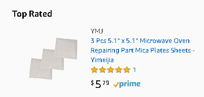

Meantime I've learned about the mica 'window' that covers the waveguide at oven wall . I think that was my trouble - it had pizza spatter on it that got turned to charcoal , probably reflecting energy back into the waveguide. Replacement mica sheet is about five bucks on Ebay or Amazon.

Magnetrons on Ebay cost from around 15 to 165 bucks , so i ordered a $15 one.
The mica window is about five bucks for enough material to make half a dozen of them.
If that doesn't fix it, well, Fair Anne gets to pick out a new one.

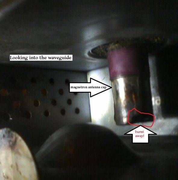

Well, it's still going after almost a week
Photo of the inside of a microwave oven cavity showing a red arrow labelled Waveguide pointing to a dark rectangular waveguide cover with a mesh screen, next to an orange and black battery package.
sorry for blurry image, my first attempt at taking a picture ever with Fair Anne's flip phone.
Photo inside a microwave oven looking into the waveguide, showing a magnetron antenna cap with a burnt-away area outlined in red and labelled burnt away, beside a perforated metal panel.
It doesn't seem to mind the burnt end.
I think it's time to cut and fit the new waveguide window.

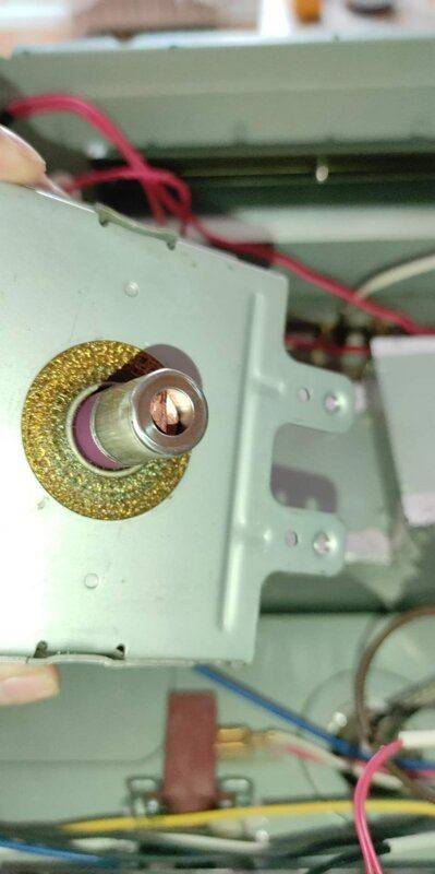

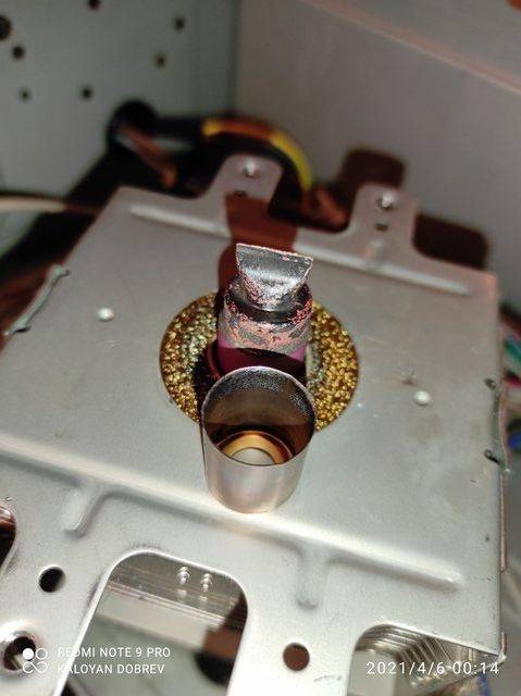

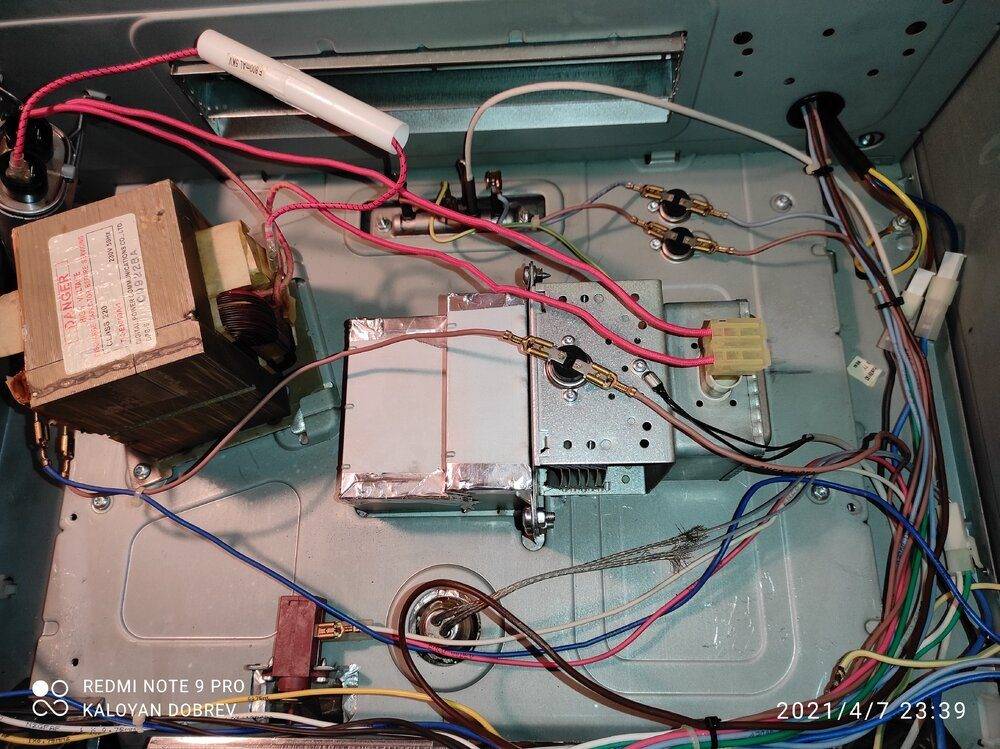

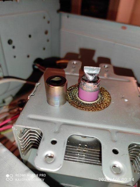

I have troubles with my microwave - the high voltage fuse keeps burning, but all electrical tests I performed showed no problems. So i think it is the charred antenna and antenna cap of the magnetron. I pulled them apart and tried to clean them with steel wool,but this is as far as i could get. Di you think i can clean them with sand paper and then polish them with 1000 grid? Would it work or they have special coating that is now or would be gone after sanding?

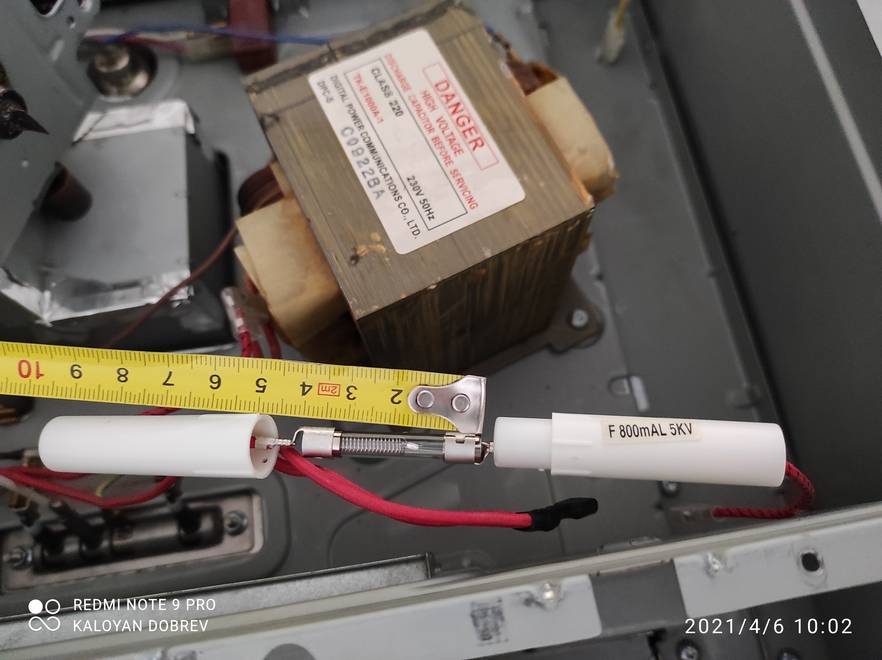

Hmm... I haven't seen a fuse in the high voltage circuit in the few I've taken apart. Can you post a photo of it with an indication of its dimensions... without getting too close to the parts than can kill you?
I have a systems engineer bachelor degree in telecommunications. I work as a developer, though. I have repaired this oven once before, and have repaired a lot of (all things i have at home and had broken at some point in the past) This is my first magnetron, but I did my extensive search on safety precautions and the supposed berilium oxide that is in the ceramic. I will take a picture , but it's specs are 0.8A 5000V.
Here is the burning fuse. It is about 40mm long but that seems irrelevant.

OK, while waiting I grabbed a pair of pliers, wrapped a fabric around the cap and started pulling and jiggling around. It came off almost not damaged. With just a tiny dent. Then I wet sanded with 400, 1000, 2000 grit sand paper. The internal part if the cap had some really nasty charred parts that I removed with a dremel and a stone.
The cap then was loose on the antenna, but with the help of a hex rock, three pins and pliers I managed to squeeze it back to a tight fit.
This is the result. I will post an update after the test.

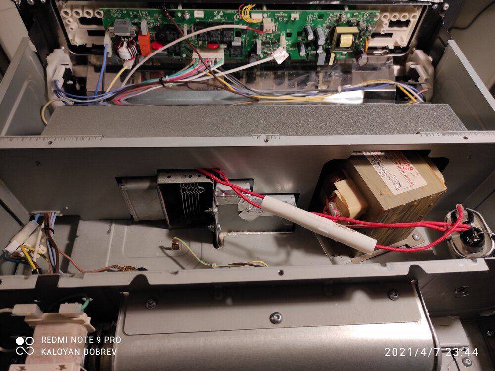

I tested and the results confuse me more. There is a strange sound coming from the oven, the fuse is not burning out, but it is not heating the glass. Everything points to a diode, but it seems fine. I will buy a replacement tomorrow and test.
Diode was changed, but still not heating, so I ended up putting a spare magnetron, that is not for this oven but managed to put it in there securely. It works now.

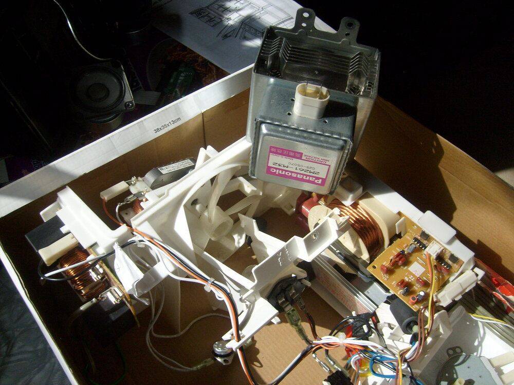

kdobrev said:
spare magnetron
Photo of a disassembled microwave oven on a cardboard box, showing a Panasonic magnetron with a pink label reading ZMC-2G... above a white plastic fan housing, transformer, capacitor, and a circuit board with wiring.
Always keep a spare magnetron. I have not needed it, but I used the main fuse (the fuse on the newer MW blew (just because)). Also used some of the cable to repair my dryer.
