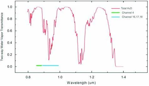

Isn't 940nm close to the water absorption peak?
Apart from cloud reflectance, there is a significant path within the atmosphere where water vapor efficiently absorbs signals at 940 nm.

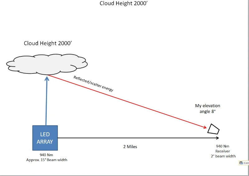

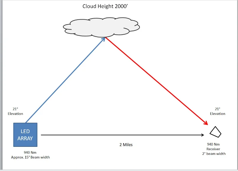

Hello Hutch,
Sorry for the delay I was away all weekend.
First thank you so much for taking the time to answer.
I agree I need to frame the question much better. Please bear with me as I am not a scientist and never went to college, just self learning .
2 attached screen shots.
The first is the current configuration of the experiment. Right angle trig says with the parameters height of the cloud and distance between transmitter and receiver the elevation angle at the RX should be approx. 8 degrees. In practice this works, after many tries with the clouds at this and other heights the math proves out.
I don't know what kind of scattering this is but I suspect not Mie scattering but I don't know. From what I researched the particle size of moisture in white clouds is somewhere 10,000 nM and 15,000 nM. Mie scattering would be more of a forward scattering with this size particle?
Screenshot 2 shows the same distance between the transmitter and receiver. However this time they are pointed at the midpoint of the 2 miles path. With this configuration both transmitter and receiver are pointed at roughly 21 degrees. 21 degrees allows for access to the cloud from many more places IE low elevations have obstacles, trees buildings etc blocking the path.
So I guess I would ask these questions
1) what type of scattering is taking place in/on the cloud ? Or is is a combination of Mie, Rayleigh, Lambertian scattering?
2) Would there be an advantage or disadvantage in reflected signal strength to orientating the light beam to the mid path as shown in screenshot 2?
I am assuming for this question that the line of sight losses between transmitter and cloud and the receiver and cloud at not considered. I am only interested in the reflection, scattering at the cloud itself.
I cannot do this experiment empirically as things change from moment to moment with the received signal strength.
Thank you so much again for your time..
Paul
W1VLF
Hello Gleb.. Yes we have found that in terrestrial experiments. Lower dew point means better signal strength. Same with the light our eyes can see. We have a water tower 10 miles distant that we use as a visual aide
Paul W1VLF
