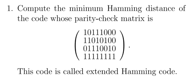

Compute the minimum Hamming distance of
the code whose parity-check matrix is
the minimum Hamming distance is the smallest Hamming distance between all possible pairs of strings in that set.
My answer:
Then, if I am not mistaken, the solution made in that video is mostly guessing about which columns combination can be equals to zero
and I found 1st, 2nd, and 3rd rows as well as 2nd, 3rd, 4th rows are equals to zero so the minimum hamming distance is 3 since my answer is mostly trial and error rather than calculating so I am not sure.

What video?
What does "guessing about which columns combination can be equals to zero"
How are 1st, 2nd, and 3rd rows equal to zero? What operation are you doing. Same question for 2nd, 3rd, and 4th rows.
That should be the minimum Hamming distance between all valid codewords, all 16 encoded strings.
H (parity check matrix):
1 0 1 1 1 0 0 0
1 1 0 1 0 1 0 0
0 1 1 1 0 0 1 0
1 1 1 1 1 1 1 1
Convert H to systematic:
xor first three rows to last row, creates identity matrix on right:
1 0 1 1 1 0 0 0
1 1 0 1 0 1 0 0
0 1 1 1 0 0 1 0
1 1 1 0 0 0 0 1
Transpose H
1 1 0 1
0 1 1 1
1 0 1 1
1 1 1 0
1 0 0 0
0 1 0 0
0 0 1 0
0 0 0 1
Create generator matrix G from H
(last four columns = first four rows of transposed H):
1 0 0 0 1 1 0 1
0 1 0 0 0 1 1 1
0 0 1 0 1 0 1 1
0 0 0 1 1 1 1 0
All 16 codewords: encoded values for data = hex 0 to hex f:
00 1e 2b 35 47 59 6c 72 8d 93 a6 b8 ca d4 e1 ff
Minimum Hamming distance between all 120 possible pairs of codewords is 4 bits. This allows a single bit error to be detected and corrected, and also a double bit error to be detected (but not corrected). A single bit error will be equal to a column of systematic H or row of transposed H:
