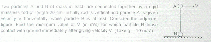

Diagram of a rigid massless rod of length 20 cm, vertical, with particle A at the top given horizontal velocity V to the right and particle B at the bottom resting on a horizontal ground line.
Honestly I have very little idea about this problem . The contact force has to vanish for particle B to loose contact .Not sure how to relate the velocity of upper particle with the normal contact force of the lower particle .
I don't think any conservation laws would work.
I would be grateful if somebody could help me with the problem.
  • Diagram of two masses A and B joined by a vertical rod, with A at the top moving horizontally with velocity V and B resting on the ground; the problem statement text is printed to the left.
Assuming that the rope have constant length and the B particle can move only horizontally, this problem must ask for the limit velocity of A just it is over B particle. If A move to right, the distance go to be larger that impossible, so B start to move with some acceleration. Think about what can be this acceleration.
Or, change frame, take origin to A particle so the problem is the same that to give horizontal velocity ##-v## to B particle. The rope is constant (again).
If B loses contact, there is no force between B and the ground any more. What happens to the center of mass? Where is B relative to the center of mass, where is it relative to the ground?

I haven't solved the problem, but would start as follows.
Remember, motion of a rigid body can be considered as motion of the CM with acceleration determined by the external forces and rotation about the CM according to the external torques.
At t=0, the system has some momentum and angular momentum.
You can write the motion of ball B in terms of the motion of the CM and the rotation about it. B should stay on the ground or lift from it: its vertical acceleration can not be negative even without a normal force.
Sorry , I can't see how to implement the above strategy to deal with this problem.
If B were to stay in contact with the floor, what would be the height, ##y##, of the CM of the system as a function of angle of rotation of the system?
Can you use this relation to find an expression for ##\ddot{y}##?

Taking upward positive and ##\theta## to be angle made by rod with the vertical .
##N - 2mg =2m\ddot{y}##
##\ddot{y} = -\frac{l}{2}[cos\theta \dot{\theta}^2+sin\theta\ddot{\theta}]##
What doe the second equation reduce at the time of interest?

My answer is in terms of the length of the rod and g. I haven't yet put in numbers. Let's see...
Yes, I get 2 m/s.
