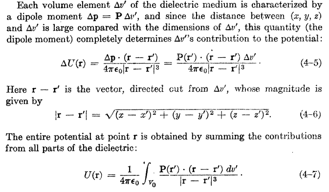

I guess there is a problem with this book in chapter 4.
Below.
The book wanna show how to find potential of a dielectric.
The problem arises when it uses a vector identity.
Still there is no problem.

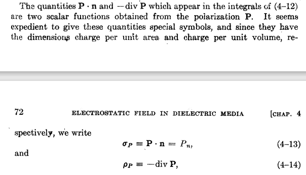

My problem is that I cannot understand why ##\rho_P= -div P##? I think it should be ##-div' P##.
The book is wrong?

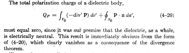

In next page it uses ##-div'##
In some other pages it uses ##div P## and this confuesd me ...
My professor didn't say anything about book being wrong in this chapter and I did not take a photo of class board. So I don't have any trusted source except here ...
P is a function of position. Inside the integral, one is integrating in prime coordinates, so P is a function of prime coordinates. The book is correct. It‘s just notation, not physics.
