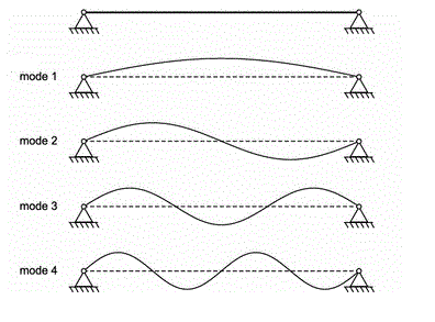

My theoretical (or finite element) mode shapes are as follows:
Diagram of a simply supported beam at top, then four mode shapes labelled mode 1 to mode 4, each showing a curved deflection between pinned supports with a dashed rest line, with 1, 2, 3 and 4 half-sine loops respectively.

Imagine for a moment that your experimental data shows that the lowest mode measured has a node at mid-span. This is not where the lowest mode should be from a theoretical perspective, but it would suggest that the lowest mode measured is actually the second mode
Do you mean to say that the measurement HAS MISSED THE FIRST MODE OR DO YOU MEAN TO SAY THAT THE FIRST MODE DOES NOT EXIST IN REALITY BUT ONLY IN THEORY? I believe the author means that the lower mode might not be excited (that is, the experiment has missed it)

Do you mean to say that the easurement HAS MISSED THE FIRST MODE OR DO YOU MEAN TO SAY THAT THE FIRST MODE DOES NOT EXIST IN REALITY BUT ONLY IN THEORY? I believe the author means that the lower mode might not be excited (that is, the experiment has missed
It exists in reality and realistically you'd always pick it up.
Consider that you have to physically excite the system to make a measurement, the best place to do this is at an antinode.
For mode 1: let's say you chose to excite the system near one of the nodes. You may not get enough into excite the big first mode.
In finding modes on physical systems, it is often necessary to excite the structure at several locations and/or more than one direction. Any single shaker input applied to a 3-D structure is likely to fail to excite 1 or more modes sufficiently. This is because any particular DOF is likely to be at or near a node for one or more modes. Of course it also depends on what frequency range of modes you are interested in.
When more than one excitation is used, you can do them one at a time, but there are techniques to use multiple inputs at once.
