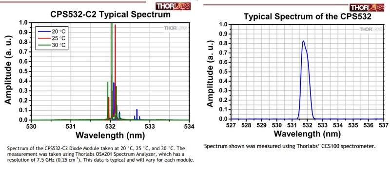

Although I am not entirely clear on your test setup, I think extracting the bandwidth from the spectrum graph may be misleading. It is only a "typical" graph and the exposure time in the spectrograph was likely on the order of milliseconds. So for any given nsec, the bandwidth may be much, much narrower.
Also, that graph was created with a Thorlab CCS100 with a resolution of 0.5nm.

I see what you mean, I was just looking for some kind of reference to work from, but I know it's quite possible that the coherence length was different. But I didn't expect it to be that long, that's the real question, because I was able to measure the interference pattern along almost 60 cm of optical path, so that's my question.
I know that those type 532nm DPSS laser people using in LUPI (laser unequal path interferometer) with a several meters difference in a path length between the arms. The fringe visibility may variate along the path according to a multiple resonator lengths.
Can be that the spec bandwidth is related to multimode operation just nor resolved by spectrometer while you are running in a single mode.

Thorlabs has two similar 532nm DPSS lasers, one 4.5mW and another 0.9 mW. If you look at the second laser spec, it has laser spectrum taken with much higher resolution. They are using Fourier spectrometer with 0.25cm -1 (or 0.007nm) bandwidth instead of diode array spectrometer with 0.25nm band.
I think that both lasers have approximately the same spectrum. I would expect more powerful laser generates more spectral lines.
It seems that spectrometer with resolution 0.007nm does not resolve single lines. Assuming 0.007nm line width that gives about 1cm coherence length, but it probably much longer.
It is a very strong possibility, in fact at first I thought that the laser I really had was the CPS532-C2, since that would fit better with what I was observing. However, I have now fully confirmed that the laser I have is the CPS532 with a much higher power. To verify this, I have contacted ThorLabs directly to inquire more about the laser, hoping that they will give me some additional information that can clarify what may be happening.
