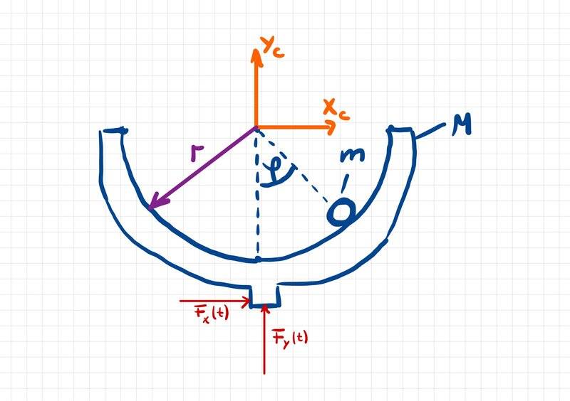

I have a question regarding a mechanical problem. I want to simulate a ball in a moving circular bowl. The dynamics of a ball in a circular bowl that is not moving can be derived in cartesian coordinates (unfortunately I need it in cartesian coordinates) via lagrangian multiplier like shown here on the last slide: https://users.physics.ox.ac.uk/~harnew/lectures/lecture26-mechanics-handout.pdf
to sum it up:
x_ddot = -(lambda/m) * (x/r)
y_ddot = -(lambda/m) * (y/r) - g
where lambda is the normal force that basically constraints the ball to stay on the bowl, g is gravity, r is the radius of the bowl and m is the mass of the ball.
Now that my bowl is moving I added a tangent acceleration to x_ddot and y_ddot due to the acceleration of the bowl like this:
x_ddot = -(lambda/m) * (x/r) - [(Fx * y + Fy * x) / r] * (y/r) // this is the acceleration of the ball
y_ddot = -(lambda/m) * (y/r) - [(Fx * y + Fy * x) / r] * (x/r) - g
where Fx and Fy can be seen as the force acting on the bowl to push it. I'm modeling it like the mass of ball has no effect on the bowl acceleration so Fx and Fy is equal to the acceleration of the bowl (assuming the Mass M of the bowl is 1). Here I only take into account the tangent acceleration of the ball due to the bowl movement. I'm running an optimal control problem where I constraint the ball to stay on the bowl. I introduced lambda as an optimization variable so the optimizer finds the correct normal force such that the ball stays on the bowl. Therefore I don't model an additional normal force on the ball based on the bowl acceleration cause this is in lambda integrated (so i only added the tangent acceleration).
The results in the simulation look good but I want to have a second opinion from some experts on my approach ;)
Because I think there is a better way to model the problem.
not that x/r = cos(phi), y/r = sin(phi) the phi is the angle between y axis and ball position.

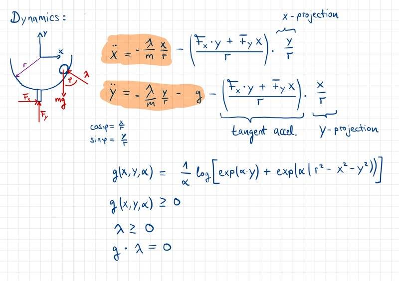

Hey :) thanks for your replies!
I should have been more specific. For now I'm modelling a 2d halfcircle in which the ball moves. this should be similar to a mass attached to a pendulum. Therefore the dynamics of the bowl and the pendulum are equal, right?
If the bowl is not moving the dynamics are then given by the orange marked equations. I'm assuming the force Fx and Fy on the bowl is equal to the bowl acceleration and I have full control on these forces (in my optimal control problem they are my control inputs).
imagine the ball lies in the equilibrium position (x=0, y=-r) I want to excite the the ball through the movement of the bowl to leave the bowl at the edges and be in freefall (to receive a juggling motion). I'm using the complementarity constraints g(x, y, alpha) * lambda to switch between the dynamics (first the ball is constrained by the normal force lambda to stay on the bowl and when it leaves the bowl there is only freefall dynamics). This is the reason why I need it in cartesian coordinates because the optimizer has problems with switches.
My general question is if my added terms to the ball acceleration x_ddot and y_ddot are correct or if I'm missing some other effects like coriolis forces, relative kinematics ect.

Ok. The conventional way to approach this is that you set up a Lagrangian. Do you know how to do that ?
Here is my current approach. Idea is to apply the lagrangian multiplier method. The radial constraint is the the circle equation where the center x_c and y_c are moving.
I'll insert the momentum equations in the second derivative of the radial constraint to determine the lambda.
What do you think about this?

That's a lot of variables. Are ##x_c## and ##y_c## degrees of freedom, or are they prescribed ? (i.e. does the ball move the bowl?)

I think you want the cup to have accelerations ##\ddot x , \ddot y## in the inertial (fixed) frame regardless of what the ball is doing in the cup. Forces ##F_x,F_y## in this case are nonsensical( you are ignoring the normal force from the ball, and the cup has no mass). I think you want to investigate 3 coordinates, and their derivatives in the Lagrangian (as has been stated). The two above and the angle ##\theta ## between one of those coordinates and a radial line through the ball since the ball is constrained to move along the arc (effectively a bead on a frictionless semicircular track). That's my interpretation.
To be fair to the OP, Post #1 states:
Anther intended assumption might be that ##m \ll M##, but there is yet no adequate problem statement (IMO).

Okay so here is the Problem Statement:
A 2-dimensional circular half-bowl of mass M and radius r is shown in the figure. Inside the bowl lies a point mass m that can move frictionlessly along the inner surface of the bowl.
The bowl is free to move translationally in the xy-plane, but it cannot rotate. As a result, moments acting about the bowl can be neglected. Two time-dependent forces, Fx(t) and Fy(t), act on the bowl, causing it to accelerate in the x- and y-directions, respectively.
Due to the bowl's motion, the point mass inside experiences a corresponding motion. Gravitational acceleration g acts in the negative y-direction.
Tasks:
Derive the equations of motion for both the point mass m and the bowl M. Represent the dynamics entirely in Cartesian coordinates (x, y) for both objects.
Determine the expression for the normal force N acting on the point mass m from the bowl's surface.

Well, if you are ignoring the normal force on the cup ( which you probably would be better off doing as a first draft ) I think you just need to give say the c.o.m of the bowl has velocities ## \dot x_c, \dot y_c ## and write the Largangian for the ball as a first step ( I don't think you can go directly to ##N## without going through what you have labeled ##\alpha##).
