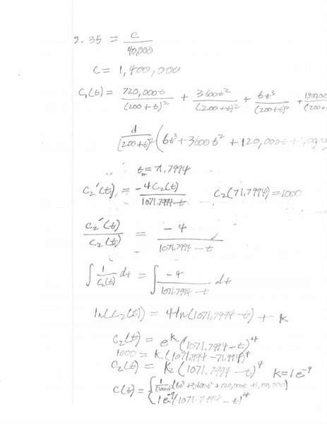

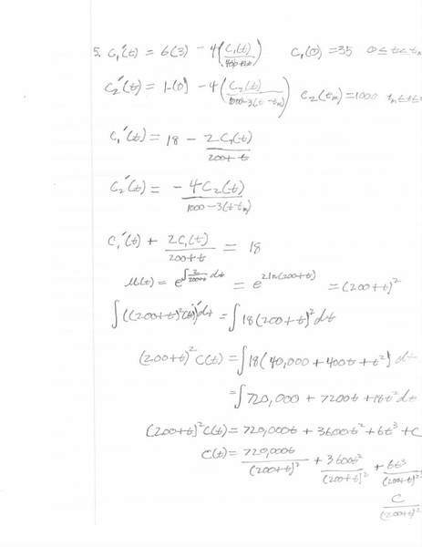

Ok so I think I have the correct answer but the problem is I don't know how to solve for the actual answer with 2 equations which one do I plug into? Sorry for all the erasing!
  • Handwritten derivation of a coupled tank mixing model: C1'(t) = 18 - 2C1(t)/(200+t), C2'(t) = -4C2(t)/(1000-3t), integrating factor (200+t)^2, and C1(t) = 729,000t/(200+t)^2 + ...
  • Handwritten calculus working for a modeling problem: c = 1,400,000 with c1(t) and c2(t) rational expressions, c2'(t) = -4c2(t)/(1071.7994 - t), integration giving ln(c2) = 4 ln(1071.7994 - t) + k, and c2(t) = k(1071.7994 - t)^4 with 1000 = k(1071.7994 - 71.7994)^4.

Oh an the 1400000 is suppose to be there sorry it is so light and I solved the t = 71.7994 using wolfram.
Uggg no replies, I guess my problem was too long or something?
Can someone please help me out I don't think it is too outrageous I have already done the work it is quite literally just plugging and playing from here my question simply is first did I get the set up right and if I did then what do I plug in at the end?
