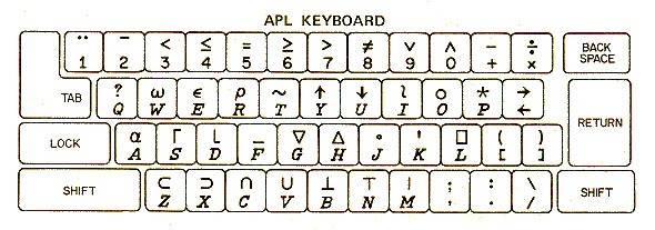

APL is quite cool. I don't recall it having that many operators. I do remember IBM using the operators in its mainframe assembler manuals to describe the function of an opcode.
I also remember a humorous open session at a conference where Prof Iverson displayed his APL language and one of the GE engineers present ask an innocent question about his keyboard not having all those arcane symbols used in APL which prevented him from programming in the language.
Iverson replied: You expect ME to design a language for YOUR keyboard, while the engineer slunk back into his seat embarrassed by the laughter of the audience.
In truth, many programmers felt the same way (but were too chicken to ask) as APL was only available on IBM systems configured to use the 3270 terminal with APL keycaps. GE had a variant but you had to type the names of the operators as in rho for ##\rho##.

APL keyboard.
There was a keyboard layout sheet that most used:
For some keyboards, you can/could order a set of APL keycap replacements. Some current APL providers also sell APL keyboards for PC.
For PC console window usage, there are/were programs to change the screen font to APL characters. This isn't an issue for GUI based APL interpreters.
