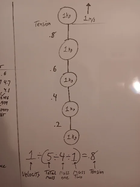

Programming a rope for a game, need to apply tension force to pairs of points to keep them together and acting like a rope, figured out how to calculate a 4 point chain (3 "rope" pairs) but having trouble past that.
In an effort to simulate a rope for a game I'm making, I'm programming a series of points that, when a connected pair moves away from each other past their max distance, applies an equal force to both points towards each other to stay within max distance by cancelling out their relative motion away from each other.
When taut this would pull connected pairs past their max distance so I need to apply the appropriate force there as well all the way down the taut connections which increases the force for the preceding pairs.
I've figured out a formula to calculate a 4 point chain (3 "rope" connections) accounting for varying angles and masses, but am having trouble past that.
I can brute force it by writing out 2 different starting values and using how much it changed between them to calculate the correct answer but that would severely slow down the program.
I wasn't sure where to put this, what prefix to use, and don't know what to look up to find it cause I'm a hobbyist and first time poster. None of the tension examples I find have the ropes connected in series, just a static object to non-static object pairing, and the one time I found a series it was just a straight line.
Any help would be appreciated.

Maybe this will clear things up.
TL;DR Summary: A straight series of points is effectively one point of all their mass combined, but how do angles in the chain of points change the tension?
When a series of points are connected in a line and acceleration is applied to one end, the tension can be calculated with just the masses.
For the example in the picture, I can calculate the tension by taking the relative acceleration between the moving point and the one it's connected to, and dividing by the total mass divided by the mass of one side of the acceleration and then divided by the mass of the other.
The result is .8 which when calculated out, shows every point moving moving .2 in the direction of acceleration. 1 m/s of a 1kg object is 1 newton of force, split between 5kg is .2 m/s, so that's correct.

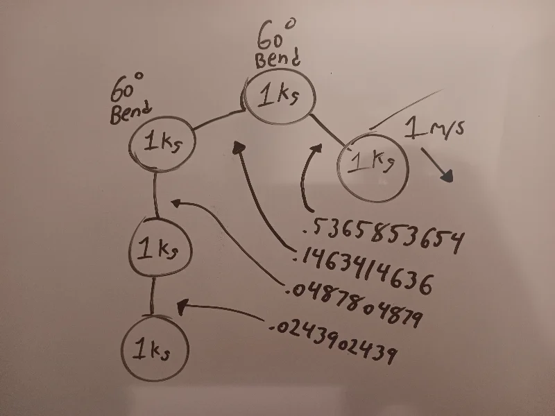

In the other picture with 2 bends, how would one get 0.5365853654 for the starting tension?
I've put together a formula for a four point chain by essentially trial and error, but I don't really understand on a practical level how the angles are affecting it.
If there's an explanation for this in a textbook or website that someone knows about that'd be good too.
Your 'trial' model is too simple - you are only considering the situation where force is applied parallel to the direction of the last 'link'. A rope model needs to cope with a more difficult situation: an initially straight rope where force is applied orthogonally.
