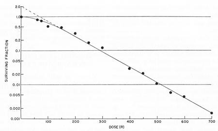

That sounds good. This is what is called a logarithmic plot (or a log-linear plot, to indicate that one of the axes is logarithmic and the other is just linear). An exponential function such as the one you have for N, will become a straight line in such a plot. This is particularly useful since for a relatively small range of x, the y-values usually go through a wide range of values and taking the logarithm keeps it all a bit more easily viewable.
Note that you can also use the property ln(a/b) = ln(a) - ln(b) to rewrite the equation to
ln(N) = - u x + ln(N0)
in which case you will get a log-linear plot for N and your starting value "b" will be the initial value N0 (although on your logarithmic y-axis, you will actually plot ln(N0).
[edit]Here is another example of a log-plot:
Note how equal distances on the y-axis correspond to multiplications instead of additions, in other words, they've plotted the log10 of the actual quantity.
(Googled it from http://www.eyephysics.com/tdf/models.htm)
