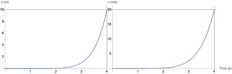

While playing with possible trajectory equations, it occurred to me that one could exploit the fact the factors of 2 are prominent. Ignoring units, the final speed is twice the distance and the time is 22. There is a single power of ##t## that will do the trick here:$$x(t)=\frac{5}{2^{15}}t^8~\implies v(t)=\frac{8\times 5}{2^{15}}t^7.$$With this,$$x(2^2)=\frac{5}{2^{15}}2^{16}=10~;~~v(2^2)=\frac{8\times5}{2^{15}}2^{14}=20.$$Note the effect of the many vanishing derivatives at small values of time.

Assume the acceleration is of the form ##a(t) = a_0 t^{\alpha}## with ##a_0, \alpha## constants. Assuming initial values are zero and given independent final values for ##x_f##, ##v_f## and ##t_f## we can solve for ##a_0## and ##\alpha##.
$$v(t) = \int_0^t a(t)dt = \frac {a_0}{\alpha+1} t^{(\alpha+1)}$$ and
$$x(t)= \int_0^t v(t)dt = \frac {a_0}{(\alpha+1)(\alpha + 2)} t^{(\alpha+2)}$$
solving for ##\alpha## and ##a_0## we get;
$$\alpha = \frac{t_f v_f}{x_f} - 2$$ and
$$a_0 = \frac{v_f (\alpha+1)}{t_f^{\alpha+1}}$$
We do require ##\alpha ≥0## as the case ##\alpha=0## is constant acceleration and it diverges for ##\alpha<0##.
We end up with;
$$a(t) = a_0 t^{\alpha} = \frac{v_f (\alpha + 1)}{t_f} \left(\frac{t}{t_f}\right)^{\alpha}$$
$$v(t) = v_f \left(\frac{t}{t_f} \right)^{\alpha+1}$$ and
$$x(t) = x_f \left(\frac{t}{t_f} \right)^{\alpha+2}$$

I have been experimenting with curves as per malawi_glenn's recommendation and I managed to get some very nice results even with crude curves.
I also implemented bob's solution above and it works even better, because there is no curve shaping required. It literally just uses two equations and the results are equally as good, with just two lines of code!
So you guys have solved my problem, seriously I cannot thank you enough. :bow:
