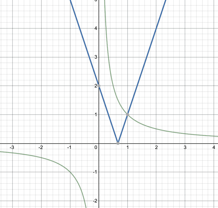

1. I think the question is asking where is the graph of |3x-2| below the graph of 1/x.
To sketch the graph of y= |3x-2| draw the line of y=3x-2 and reflect the section with negative y-values in the x-axis. Alternatively, I could set 3x-2 ≥0, meaning |3x-2|=3x-2 so draw the line of y=3x-2. Then find 3x-2≤0, meaning |3x-2|=-(3x-2)=2-3x so draw the line of y=2-3x.
Then plot the graph of y=1/x and find the point of intersection between the modulus graph and y=1/x.
This is equivalent to asking where does the modulus of 3x-2 meets the curve y=1/x;
|3x-2|=1/x
The critical values are 0 and 2/3

One is also able to evaluate this by sketching both of the graphs. The point of intersection is found to be (1,1). Since the graph of y=1/x has a horizontal asymptote of y=0, meaning when x is negative the graph of y=1/x is below the graph of y= |3x-2|
Therefore, combining the solutions to find the set of values for which |3x-2|<1/x this would be when 0<x<1.

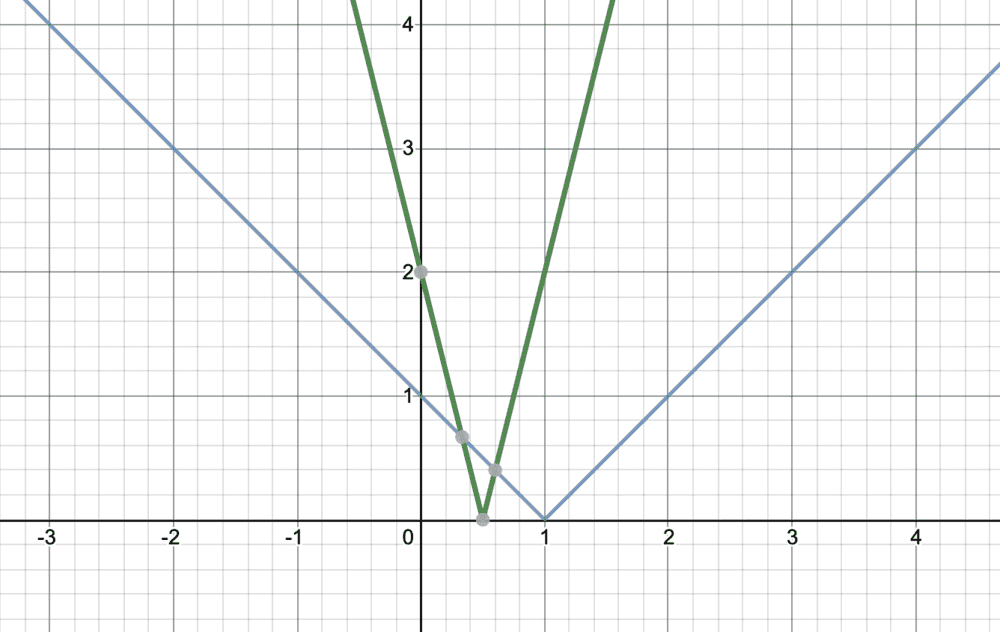

For 2, your graph is wrong.

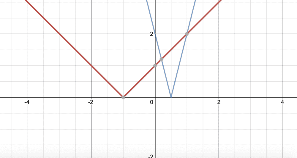

I have tried to correct my graph for part 2? Sorry, I think I accidentally graphed |x-1| instead of |x+1|?
Besides from this would my workings be correct? Is is there a preferable method to solve modulus inequalities like these instead? 😁

Yes, that's the right graph now.
Solving nonlinear inequalities does tend to be messy, often needing to be broken down into cases. Graphing is certainly helpful in guiding you.
There can be quicker ad hoc methods. In the second question you could have written it as (x+1)2>(4x-2)2.
This quickly simplifies to (5x-1)(x-1)<0, whence 1/5<x<1.
