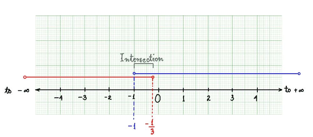

Thank you all for your replies. I realize now that the intervals I had found in my answer, viz. ##x\in(-\infty, -1/3)\cup (-1, +\infty)## includes all numbers. I suppose my error was in perhaps thinking that ##-1>-1/3##. The problem underscores the fact however that some intervals, or parts of an interval, can include parts of another intervals. I draw the two intervals on the number line below, for this problem, to represent the answer as the book put it : ##x\in (-\infty, +\infty)## :
Well done and nice picture!
