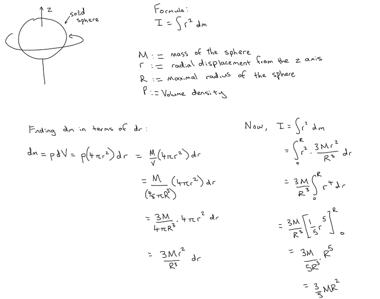

So I have been having a bit of trouble trying to derive the moment of inertia of a solid sphere through its center of mass. Here is my working as shown in the attached file.
The problem is, I end up getting a solution of I = (3/5)MR^2, whereas, in any textbook, it says that the inertia should be equal to I = (2/5)MR^2. Is anyone able to tell me where I went wrong in my working? This is not a homework problem by the way.
Thanks.

You are using ##r## with two different meanings and mixing them up. 1) The distance from the axis of rotation (the ##r## in the definition of the moment of inertia). 2) The distance from the centre of the sphere. These are not the same.

Just to add something to Orodruin's enlightening post,
In many moment of inertia calculations these two meanings happen to be the same thing (for example in the calculation of the Moment of Inertia of an infinitesimally thin circular disc, the distance from the axis of rotation (that passes through the center and is perpendicular to the plane of the disc) equals the distance from the center of the disc ) BUT in the general case they are not the same thing and in this case they are not the same thing.
What is the equation that relates r' (the distance from the axis of rotation) and r (the distance from the center of the sphere) in this case?
Also the dV you calculate is not the same as the dV that appears in the definition of the moment of inertia. You calculate the infinitesimal volume between a sphere with radius r and radius r+dr. But the dV in the integral in the definition of the moment of inertia is ##dV=r^2\sin\theta dr d\theta d\phi## (r is the distance from the center of the sphere). You just can't use your definition of dV because if you find the equation of r' correctly you ll see that it depends on ##\theta## and ##r## and not only ##r##.
Hey question poster.. The moment of inertia of a solid sphere about that axis is 2/5mR^2 and not 3/5mR^2.. the mistake you did there is that when you were writing the MOI of the infinitesimally small 3d element there, you should NOT use the formula dmr^2 but instead that is a hollow sphere!! See the infinitesimally small element you cut forms a hollow hemisphere!! There you derive THE MOI of solid sphere using MOI of hollow sphere that is using the formula (2/3 * dm r^2) this is what should be used! I hope that clarifies
