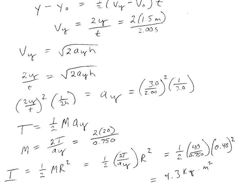

I think I have solved the problem correctly and through my method I determine the moment of inertia to be 4.3 kg*m^2. However I'm not sure if the equations I used to find velocity and acceleration are valid in this situation.
I think the assumption you have made (that is not necessarily true) is that the wheel is a uniform disk.
Once you found the linear acceleration of 0.75 m/s2, you can directly find the angular acceleration alpha from [itex]a=r\alpha[/itex].
Then you can use the torque equation like you did, but there is no need try to write out an expression for I, since I is what you want. Just use:
[tex] \tau = I\alpha[/tex]
and solve for I.
