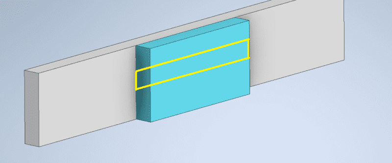

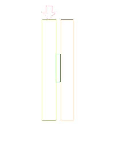

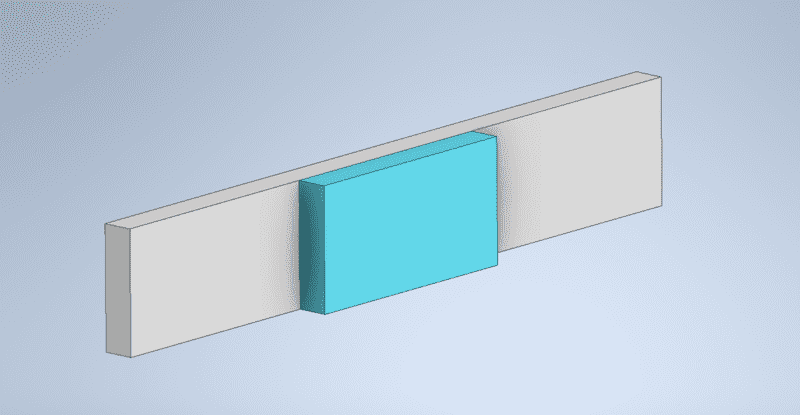

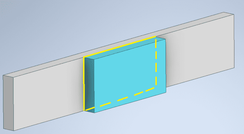

If two plates of Aluminum (both are 2" tall, and 1/2" thick) were placed over each other (see photo 1) and then welded together all around the perimeter of the second plate (the blue one) as indicated by the yellow lines in photo 2, then would the moment of inertia be calculated as if the local section (only where they are connected) was 2" by 1"? And would the same apply if the second plate was bolted to the first plate using many bolts?
second moment of area/moment of inertia = "I" in the bending stress formula sigma = My/I

Lnewqban said:
Thank you for the links L, I really appreciate them. In the first link however it doesn't say anything about welded plates equating to one solid piece. I want to understand why it is that this first and second plate in my example can become as load bearing as a genuine fused and homogenous 2" x 1" bar when it only has two continuous weld beads connecting it. I want to know the "how" of it.
By clicking on the link located at the bottom right corner of each page of that first link, you will be taken to the next page, which has some explanation and comparison of resistance to bending between beams formed by attached and detached layers of material.
The welding creates a path for the shear flow, preventing sliding of the plate respect to the square.
The additional plates locate more cross-section material away from the neutral axis (where is more helpful), increasing the moment of inertia.

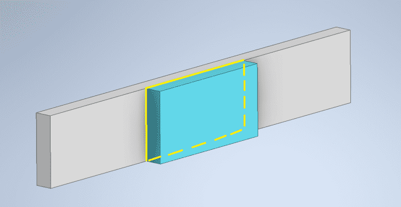

L, one more question for you, what if you didn't weld directly around the perimeter, but instead welded a perimeter smaller than the total height and width of the second plate like in this photo? You wouldn't be able to then consider it as one piece then right?
No, I wouldn't consider it as one bending-resistant effective piece.
You would be increasing the cross-section, but stress on the welding would be too big.

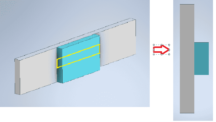

Hm, I thought so too. I read through your 80's book until page 112, it did help me to better conceptualize this concept. I like what you said, "the welding creates a path to for the shear flow..", this makes me think that it is the weld being placed all the way at the bottom and top of the plate that allows it to transmit its shear flow to the the entire height of the 2nd plate, rather than just a portion of the plate if it were welded with that smaller perimeter.
If you were to only weld that small perimeter, I suppose the new cross section would look something like this?
No, more like this:
