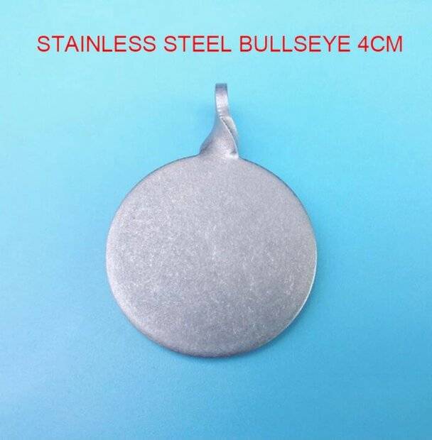

Hello to all, I wish to detect the hit of a airsoft pellet on a shot plate with an ESP32 board.
to do this I have basically two options:
Either, detect the signal as digital (hit / missed) or detect the signal as analog signal with a piezo disks.
The analog signal will have more information within the detection that i might be able to 'decode' at a later stage so this is my preferred option,
Then there is the option to just add a piezo disk to the shot plate and hope for the best, on the other hand I can try to calculate the most efficient setup.
To do this I would need to go and calculate a few things:
1) Energy transfer (pellet ot shot plate),
2) Shot plate (mounting) physics,
3) Piezo disk size, thickness,, mounting.
So for now I have taken in consideration the following.

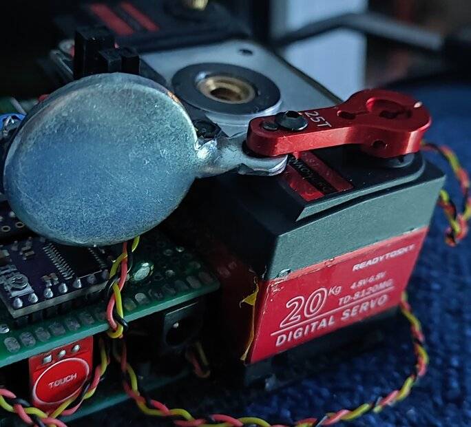

the shot plate is a round steel disk (R = 20mm, h = 3.0mm) and is will be atteched through a little stem on one side which has a trough hole, through which there will be a little bold. and the rim will have a U cut out and another bolt will go through that. that all ia attached to a 20KG servo arm and the total lenght of arm and disk will be. 55mm (R = 20 + 25mm)

A round plate has multiple natural frequencies. The relative magnitude of each natural frequency depends on where the pellet hits the plate. One mode has the plate bending into a U shape. Fastening at one point on the edge makes the plate asymmetric, so the natural frequency of that mode will be different depending on the direction of the U. You will not find equations for the natural frequency of a round plate with your mounting. The equation for natural frequency with edges free (plate floating in air without support) should give a number that is in the ballpark.
Strongly exciting a natural frequency requires that the duration of impact be less than 1/2 the period of that natural frequency. You can estimate the duration of impact from pellet velocity and length. If the duration of impact is longer than the period of a natural frequency, any excitation of that frequency will be minimal.
Why do you need natural frequencies? What is the purpose of that servo? If you are using the servo to return the plate after a hit, then the pellet is hitting hard enough to move the plate. The servo should be able to output a position error signal after the hit, which you could use for your hit detection. The industrial servos I am familiar with will do that, I'm not familiar with the capabilities of those little hobby servos.

Oke, the approach of a servo giving an potition error is intrequing. I had not considered that, so my fisrt step will be to dive in that and see if I can get the info and ifso see if i can get info on the amount of displacement.
I have found that the servo (not even connected, responds back upon a push against the arm, so it should give some of that info back. Intreguing, very intreguing indeed.
If not, then I will go with the floating plate approximation.

Well yeah, similar.. a piezo disk can indeed be used as detection (microphone) or as a production source (speaker) here a detection ofcourse. for microphones they tend to be as free floating as possible i believe, but here i wish to get the vibration caused by the hit directly transfered to the disk, not use the "soundwaves" traveling through the air, so a mount in one way or another is applicable. I have taken in consideration the 4 following "mounts"
1) glue it flat against the back of the plate (type of glue should be taken in consideration here too, a hard glue like cyanoacrylate, a something more silicon based like an E9000 that remains flexible)
2) mount in a standard ring, that come with some of the disk upon supply.
3) attach on one side of middle of the disk.
4) attach on sides of the disk (two / three?)
but as for now i will dive into the servo suggestion jrmichler gave.
