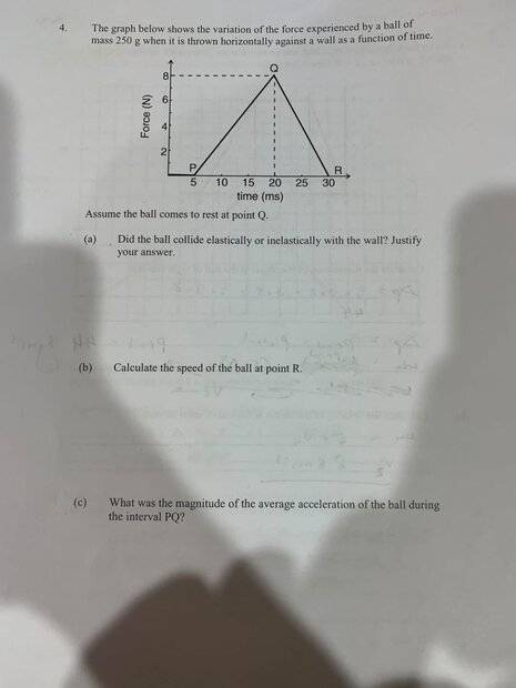

See attached.
Graph shows variation of force experienced by ball of 250g mass when thrown against a wall. Comes to rest at point Q.
a) Did the ball collide elastically or inelastically with the wall? Justify.
b) Calculate the speed of the ball at point R
c) What was the magnitude of the average acceleration of the ball during the interval PQ?
F=ma
change in momentum = final - initial
change in momentum = force x time
a) Assuming it is inelastic as it is accelerating and therefore kinetic energy is not conserved? Intuitively this doesn't feel right...
b) change in momentum = p initial - p final = force x time
p initial = 0 as at rest
p final = 0.25 x v2
force x time = area under graph = 0.1
therefore 0.25 x v2 = 0.1
v2 = 0.4 ms-1
c) After google searching I have discovered that acceleration is the area under the graph of a f against t graph, but I am certain I have not been taught this. Is there are more intuitive way to figure this out?
Many thanks!
Handwritten-style printed problem sheet with a graph of force in newtons against time in milliseconds: a triangular force-time curve rising from P at 5 ms to a peak Q near 8 N at 20 ms, then falling to R at 30 ms.

This is indeed not sufficient. During the collision, energy can be stored up as potential energy in deformation of the ball etc. You will need to find a different line of argument here. What is significative of an elastic collision of an object with an immovable object (such as a wall)?

Why would the ball be at rest initially? It is being thrown against the wall.
I may be missing something here as your image is really low quality and it is difficult to see what it actually says.

For "part a"
I don't think we can show this. If the collision is perfectly elastic, then we expect the change in momentum to be ## 2 m v_P ##
This implies to answer the question we have to compare:
$$ \int_{\rm{5 ms}}^{\rm{20ms}} F_{PQ} \, dt + \int_{ \rm{20 ms}}^{\rm{30 ms} } F_{QR} \, dt < 2 m v_P $$
But, we don't know the momentum of the ball before the collision? Unless I'm missing it in the picture somewhere.
and for the same reasons we can't calculate "part b" either?
We are told the ball is instantaneously at rest at point Q.
Oh...I didn't see that. I realized that must be the case, but it didn't click for some reason to use that fact to find the initial momentum.
