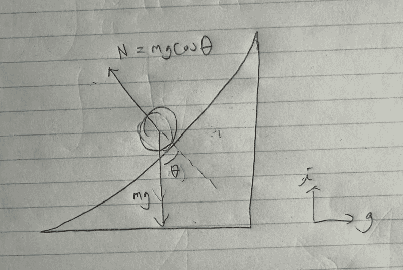

Let's consider a ball rolling up the following circular slope. Let's assume it rolls up the slope until it reaches the top - afterwards, it rolls back down. Let's consider the change in momentum of the ball in the direction of j.
At the time ##t_\rm{initial} ## , when the ball is at the foot of the slope, the ball has velocity 0 in the direction of j - all its velocity is directed in the horizontal direction. At the time ##t_\rm{final} ##, when the ball is at the top of the slope, the ball has velocity 0 in the direction of j too - this is because we're at the point just before the ball rolls back down. This means that the change in momentum between these 2 points in time is 0.
However, we also know that the change in momentum between 2 points in time can be given by integrating the external forces acting on the ball in the j-direction. There is always an external force acting on the ball in the direction of j as it climbs up the slope - we've got gravity and the normal force, and the j-components of those 2 don't always cancel out. So the integral ##\int_{t_\rm{initial}}^{t_\rm{final}} F_\rm{external} \, dt## is non-zero

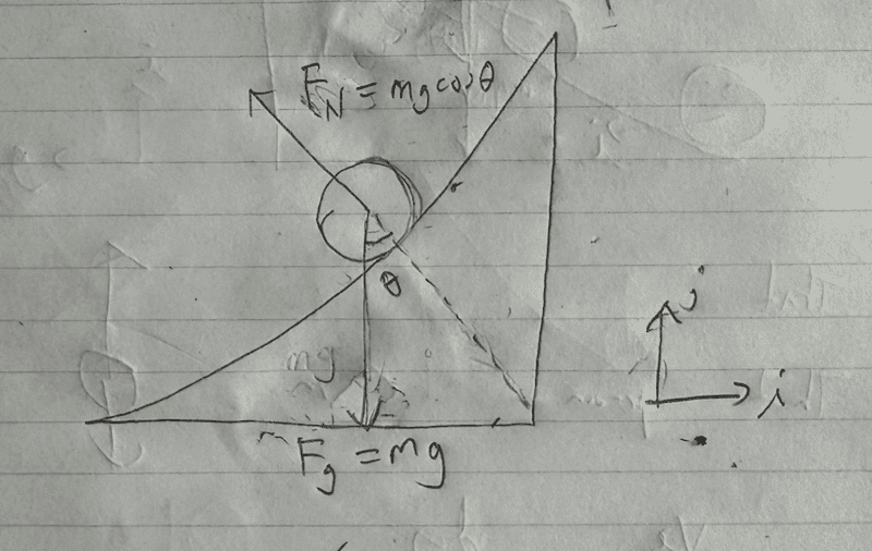

This is my reasoning:
At any point in time, let us denote the normal force acting on the ball as ##F_\rm{N}##, and the gravity force as ##F_\rm{g}##. If we take the angle between the vectors for ##F_\rm{N}## and ##F_\rm{g}##, we can see that the magnitude of ##F_\rm{N}## = ##mg cos(\theta)##.
Since the magnitude of the normal force is less than the magnitude of the gravity force, the magnitude of the j-component of the normal force should also be less than the magnitude of the j-component of the gravity force (since gravity acts exclusively in the j-direction).
Could you point out where my reasoning is wrong? I'd appreciate it.
You need to reason more carefully.
Write down the Newton's second law force balance (##\sum F = ma##) in the vertical direction. For convenience, let ##a = 0##. See if you get what you say you get.
Aurelius120 said:
If the ball is moving on a curve, the required Centripetal force will be provided by difference in respective components of ##mg## and ## N##
So depending on Radius of Curvature, Normal might exceed weight
That could be a reason but I am no expert
That is indeed the reason.
In the question as stated, there is also static friction, which will have a vertically upward component. But we can recast the question as being frictionless and ignore the rotation of the ball. It is still true that as the ball starts up the ramp it is accelerating upward, so N exceeds mg.

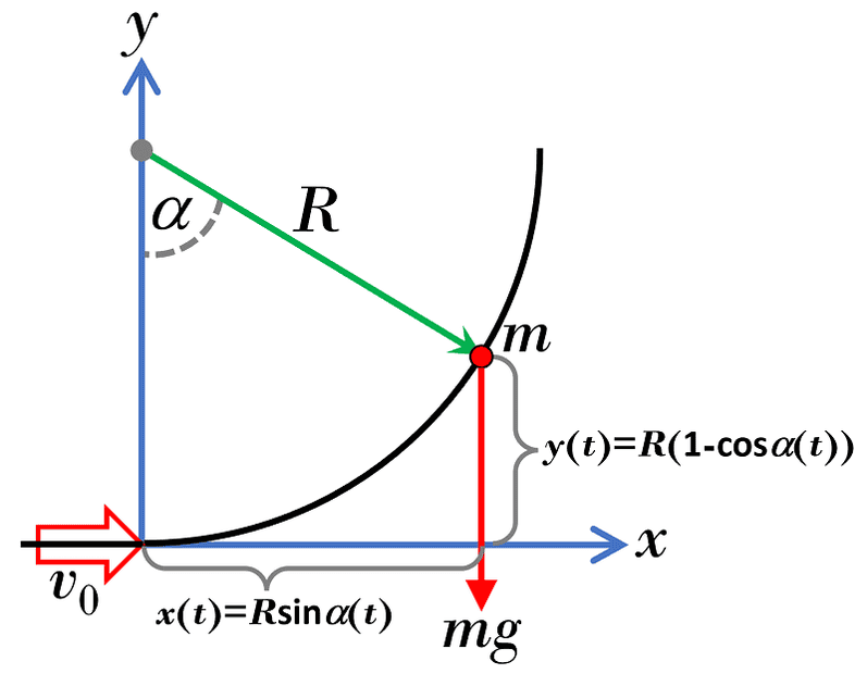

Let's look at this scenario in more detail by simplifying the problem to be a bead of mass ##m## sliding, without rotation, on a frictionless, circular ramp of radius ##R##. Below is the configuration that I will consider:
I begin by ignoring dynamics (forces, energies and equations of motion) and focus, for the moment, on kinematics. The coordinates of the bead as a function of time ##t## are determined by the single parameter ##\alpha(t)##:$$x\left(t\right)=R\sin\alpha\left(t\right),\quad y(t)=R\left(1-\cos\alpha\left(t\right)\right)\tag{1a,b}$$where ##0\leq t\leq t_f##. Here ##t=0## represents the moment that the bead first enters the ramp, with initial velocity ##v_0## in the ##x##-direction, and ##t=t_f## is the time when the bead reaches it's maximum height in the ##y##-direction, with an instantaneous velocity of zero. The range of the angle ##\alpha## is thus ##0=\alpha (0)\leq\alpha(t)\leq\alpha(t_f)##, where ##\alpha(t_f)## is to be determined from the dynamics of the problem. The components of the initial and final velocities are therefore:$$\left(\dot{x}\left(0\right),\dot{y}\left(0\right)\right)=\left(v_{0},0\right),\quad\left(\dot{x}\left(t_{f}\right),\dot{y}\left(t_{f}\right)\right)=\left(0,0\right)\tag{2a,b}$$I compare this expression to eqs.(1) and their first-derivatives:$$\dot{x}\left(t\right)=R\cos\alpha\left(t\right)\dot{\alpha}\left(t\right),\quad\dot{y}\left(t\right)=R\sin\alpha\left(t\right)\dot{\alpha}\left(t\right)\tag{3a,b}$$to conclude that ##\dot{\alpha}## satisfies the conditions: $$\dot{\alpha}\left(0\right)=\frac{v_{0}}{R},\quad\dot{\alpha}\left(t_{f}\right)=0\tag{4a,b}$$Now I examine accelerations by differentiating eqs.(3) to find:$$\ddot{x}\left(t\right)=-R\sin\alpha\left(t\right)\dot{\alpha}^{2}\left(t\right)+R\cos\alpha\left(t\right)\ddot{\alpha}\left(t\right),\quad\ddot{y}\left(t\right)=R\cos\alpha\left(t\right)\dot{\alpha}^{2}\left(t\right)+R\sin\alpha\left(t\right)\ddot{\alpha}\left(t\right)\tag{5a,b}$$Note that at ##t=0## the ##y##-acceleration is ##\ddot{y}\left(0\right)=v_{0}^{2}/R##; i.e., the bead experiences an instantaneous centripetal acceleration in the vertical direction, as expected. But in the horizontal direction, ##\ddot{x}\left(0\right)=R\,\ddot{\alpha}\left(0\right)##, which demands that ##\ddot{\alpha}(0)=0## since there is no force exerted on the bead in the ##x##-direction at the moment it enters the ramp. Overall then, the kinematics of the sliding bead dictate the following conditions on the angle ##\alpha(t)##:$$\alpha\left(0\right)=0,\quad\dot{\alpha}\left(0\right)=\frac{v_{0}}{R},\quad\ddot{\alpha}\left(0\right)=0,\quad\dot{\alpha}\left(t_{f}\right)=0\tag{6a,b,c,d}$$To progress further requires dynamics. The equation of motion for ##\alpha(t)## can only be solved implicitly in terms of an elliptic integral of the first kind. But there's no need to go that far to address the OP's concern. Instead, I use the conservation (constancy) of the total energy ##E\equiv E_{\text{kinetic}}\left(t\right)+E_{\text{potential}}\left(t\right)## to write:$$E=\frac{1}{2}m\left(\dot{x}^{2}\left(t\right)+\dot{y}^{2}\left(t\right)\right)+mg\,y\left(t\right)=E\left(0\right)=\frac{1}{2}mv_{0}^{2}\tag{7}$$Dividing by ##g## and using eqs.(3) to eliminate ##\dot{x},\dot{y}## in favor of ##\dot{\alpha}## converts eq.(7) to:$$\frac{E}{g}=\frac{mv_{0}^{2}}{2g}=m\,y\left(t\right)+\frac{mR^{2}\dot{\alpha}^{2}\left(t\right)}{2g}\tag{8}$$Differentiating this twice w.r.t. time yields the expression for the the force in the ##y##-direction ##F_y##:$$m\,\ddot{y}\left(t\right)\equiv F_{y}\left(t\right)=-\frac{mR^{2}\left(\ddot{\alpha}^{2}\left(t\right)+\dot{\alpha}\left(t\right)\dddot{\alpha}\left(t\right)\right)}{g}=-\frac{d}{dt}\left[\frac{mR^{2}\dot{\alpha}\left(t\right)\ddot{\alpha}\left(t\right)}{g}\right]\tag{9}$$Eq.(9) gets to the crux of the OP's question. OP asserts that the time-integral of the integrand on the right side of (9) must be non-zero. But that assertion is false because the integrand is not manifestly of a single sign. Instead, on the solution set for ##\alpha(t)##, the integrand varies in sign such that the time-integral of the force from ##0## to ##t_f## does indeed exactly vanish:$$mv_{y}\left(t_{f}\right)-mv_{y}\left(0\right)\equiv\intop_{0}^{t_{f}}F_{y}\left(t\right)dt=\frac{mR^{2}}{g}\left[\dot{\alpha}\left(0\right)\ddot{\alpha}\left(0\right)-\dot{\alpha}\left(t_{f}\right)\ddot{\alpha}\left(t_{f}\right)\right]=0\tag{10}$$ in view of the conditions (6c,d).
