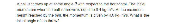

if an object's velocity at the highest point of a trajectory is 0, how can it still have momentum (since p = mv)? is this question technically correct?
I think you mean to say, vertical component of velocity, there is no force acting in the horizontal direction, hence it would remain a constant. try doing the rest.

it went from 6.4 to 4.6 , and mass stays the same so I thought velocity decreased
yes it did, but only the vertical component of the velocity changed, not the horizontal, this means that the momentum at the top considers only the horizontal velocity.

but we don't know the mass to find horizontal velocity
it's okay don't worry. start off with the problem. Find the horizontal component of the initial momentum. in terms of ##\theta##

cos theta x initial velocity or in this case Vinitial = p/m = 6.4 / m
the momentum is 6.4. Find the initial horizontal component of it.

nvm, answer is 44 degrees, i figured it out. thank you!
Good, now what happens to this value as the particle reaches its highest position?

Isn't the final momentum given? so find the final velocity and equate to the horizontal velocity you got.
how do you find the final velocity if you don't know mass?
Again don't worry keep it as a variable, and find the final velocity and equate, m WILL get cancelled.

6.4 / m times cos theta = 1/2 m Vf^2?

NO.
i told you to equate the final VELOCITY and ##\frac{6.4}{m}\cos\theta##

answer is 44 degrees?
Yes :smile:

Summary:
Initial horizontal momentum = final horizontal momentum...eq1
notice I'm using momentum,
initial momentum= 6.4 units
initial horizontal momentum = ##6.4 \cos\theta##...eq2
final horizontal momentum(highest position) = final momentum =4.6units...eq3
because vertical momentum = 0
hence from eq 1,2, and 3
we have $$6.4\cos\theta = 4.6$$
hence get ##cos\theta##
ok?
